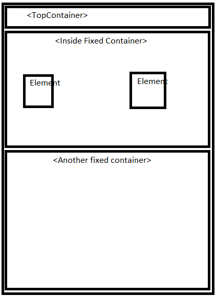

I need to have something like a Container with a list representation where the elements can themselves be containers or "normal" nodes, and not just text. They should be resized with the top container. How would one do that?
Example see attached image
This compartment/region behavior is not yet supported in Sirius. This
corresponds to the enhancement bug 436359 [1]. Some experimental work
has already been done and is present in Sirius 1.0.0. But it requires a
manual modification of the VSM (the odesign file) in a text editor.
A current possibility could be to create a Top container mapping
(children presentation = FreeForm) with sub container mapping (children
= FreeForm regarding your sketch). By default they will be standard
container, children of the main container, the user can move, resize and
layout them as he wants.
Then to activate the experimental compartments capability, open your
odesign in a text editor and replace childrenPresentation="FreeForm" by
childrenPresentation="VerticalStack" for your top container mapping.
This will activate the Region/RegionContainer user interactions and
layout on your Top/Fixed containers.
Maxime

Re: Container with fixed freeform presentation [message #1384936 is a reply to message #1384857] Tue, 03 June 2014 04:40 Go to previous messageGo to next message
Thanks for you reply Maxime.
Do we have the possibility to show any item with 90º rotation?
Re: Container with fixed freeform presentation [message #1384958 is a reply to message #1384936] Tue, 03 June 2014 05:58 Go to previous messageGo to next message
Sirius does not provide this possibility. You could try to provide some
specific editpart/style/figure but you might encounter some issues to
make it work on all platforms.
Maxime
Re: Container with fixed freeform presentation [message #1385463 is a reply to message #1384958] Fri, 06 June 2014 11:11 Go to previous message
I began this kind of work but stopped on the way.
Here are the steps to reach your Objective:
  • Implementing a gmf edit part provider extension point for your container and contained node
  • Get the map of newly-to-synchronize gmf views in the ViewpointLayoutDataManager and remove them to disable Sirius automatic layouting at creation
  • Implement your own Gef LayoutManager for your node
Good luck for that job, that's not so easy to do.
Regards, Charlie
