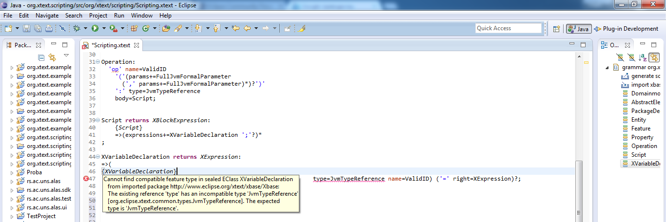

I have similar issue as Heinrich, I would like to have local vars in XBlockExpression without val /var. I tried next:
Operation:
'op' name=ValidID
'('(params+=FullJvmFormalParameter
(',' params+=FullJvmFormalParameter)*)?')'
':' type=JvmTypeReference
body=Script;
Script returns XBlockExpression:
{Script}
=>(expressions+=XVariableDeclaration ';'?)*
XVariableDeclaration returns XExpression:
{XVariableDeclaration}
type=JvmTypeReference name=ValidID) ('=' right=XExpression)?;
but there is bug (error2.png in attach)
does anyone know what is the problem?
Thank you in advance,
Marko
  • Attachment: error2.png
    (Size: 99.18KB, Downloaded 163 times)
Re: XBase : How to strip "var/val" in XVariableDeclaration [message #1426061 is a reply to message #1425864] Thu, 18 September 2014 03:27 Go to previous messageGo to next message
Hi Marko,
how does the header of your grammar look like? Which version of Xtext do
you use?
Do you have org.eclipse.xtext.xbase and org.eclipse.xtext.common.types
in your dependency list?
Sebastian

Re: XBase : How to strip "var/val" in XVariableDeclaration [message #1426313 is a reply to message #1426061] Thu, 18 September 2014 10:59 Go to previous messageGo to next message
Thank you Sebastian for your answer, I use xtext 2.6, I have xtend library on build path of project (it contain org.eclipse.xtext.xbase and org.eclipse.xtext.common.types)
Xtext grammar:
grammar org.xtext.scripting.Scripting with org.eclipse.xtext.xbase.Xbase
generate scripting "http://www.xtext.org/scripting/Scripting"

Re: XBase : How to strip "var/val" in XVariableDeclaration [message #1426348 is a reply to message #1426313] Thu, 18 September 2014 12:02 Go to previous messageGo to next message
Could you try to add another import:
import "http://www.eclipse.org/xtext/common/JavaVMTypes" as types
Any chance to try 2.7.x? If that doesn't work, please file a ticket.
Sebastian

Re: XBase : How to strip "var/val" in XVariableDeclaration [message #1429418 is a reply to message #1426348] Tue, 23 September 2014 03:53 Go to previous messageGo to next message
Hi Sebastian,
Thank you very much and sorry for delay of my answer.
It works, I can write int a = 5 without val/var in XBlockExpression.
but, I have one more question,

Am 23.09.14 09:53, schrieb Marko Markovic:
> Hi Sebastian,
> Is possible write next in XBlockExpression?
> int c = 5
> move(c)
> I tried next:
> Operation:
> 'op' name=ValidID
> body = XBlockExpression
> =>({XVariableDeclaration}type=JvmTypeReference name=ValidID) ('=' right=XExpression)?;
> XExpression returns XExpression :
> XAssignment | Move;
> Move:
> {Move}
> 'move' '(' (expression+=XExpression)? ')'
> but in editor I have error: The TypeResolutionStateAdapter was removed while resolving - See error log for details (error1.png in attach)
> Do I change grammar or something else?
> Marko

Sorry, I misread you post.
Looks like you tried to introduce a new expression type but did not
implement the necessary services (thats what's indicated by the error at
least).
Looking for professional support for Xtext, Xtend or Eclipse Modeling?
Go visit: http://xtext.itemis.com

Hi Sebastian,
Thank you on your answer, can you help me about specialize the parser rule ValidID as you wrote in one of last post?
Sorry if it is easy, i'm beginner in xtext.
Thank you very much,
Marko
Re: XBase : How to strip "var/val" in XVar [message #1430569 is a reply to message #1429890] Wed, 24 September 2014 10:15 Go to previous messageGo to next message
Am 23.09.14 23:51, schrieb Marko Markovic:
> Hi Sebastian,
> Marko
Hi Marko,
that was a mistake of mine. I assume the idea to have a Move expression
put you on the wrong track. Anyway, ValidID can be overridden like this:
ValidID: ID | 'Move';
But as I tried to say, it wouldn't solve your problem since you
introduced a new expression and need to have all infrastructure
components for that one available (type inferrer, compiler, ..)
Sebastian

Thank you Sebastian on your answer, I tried it (ValidID: ID | 'Move'Wink and I had error and I didn't know what I need to do next.
If you find some similar example I would be very grateful to you.
Marko
Re: XBase : How to strip "var/val" in XVar [message #1440498 is a reply to message #1430649] Wed, 08 October 2014 08:47 Go to previous message
I solved this problem, I created xtend class AlasTypeComputer in package ...typesystem and AlasCompiler.xtend in package ..jvmmodel and bind in MyDslRuntimeModule
public Class<? extends XbaseCompiler> bindXbaseCompiler() {
return AlasCompiler.class;
public Class<? extends ITypeComputer> bindITypeComputer() {
return AlasTypeComputer.class;
If someone would like more detail about this I'm here Smile
Marko
