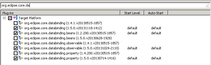

Ok, now it's working Smile. I've changed the plugin version for org.eclipse.core.databinding.beans from 1.5 -> 1.2.2 in my target platform.
I've attached a file with my current configuration of the target platform. Right now I don't like the mixing of the 1.5 version with the lower version. What do you think on that?
Still my question would be why the 1.5 version did not work. I was trying to find the source code for the 1.5 version without any success.

1.5 is experimental code from the e4 project - the sources are hosted at
http://git.eclipse.org/c/e4/org.eclipse.e4.databinding.git/
