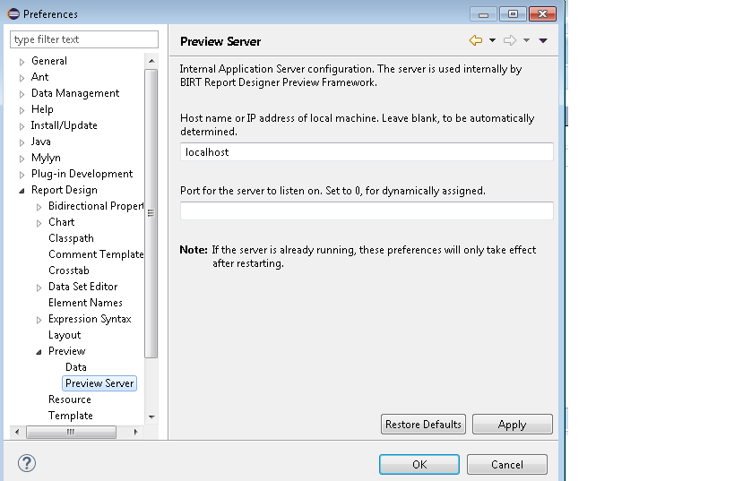

Re: View Report in Web Viewer Error [message #1700355 is a reply to message #1341568] Thu, 02 July 2015 03:07 Go to previous messageGo to next message
This is Rajat...
I also faced this problem and got a resolved it by below steps :
1) Lower down your browser setting by going in to "internet option" in 'Security'
lower down the level of 'internet' and 'trusted sites' to medium/low.
2) In eclipse go into 'Windows' - > 'Perferences' -> 'Report Design' - > 'Preview' - > 'Preview Server' and type 'localhost' in first tab (Host name) and click apply.
Please try this...
It got working for me... Razz
  • Attachment: viewerror.jpg
    (Size: 24.34KB, Downloaded 1457 times)
Re: View Report in Web Viewer Error [message #1700382 is a reply to message #1410418] Thu, 02 July 2015 05:49 Go to previous message
Lower down the security of internet explorer related to internet and local by going in internet option
also
Go to Eclipse - > Windows - > Preferences - > Report Design - >Preview - >Preview Server and type 'localhost' in first tab (host name)
or
else install latest internet explorer 11
