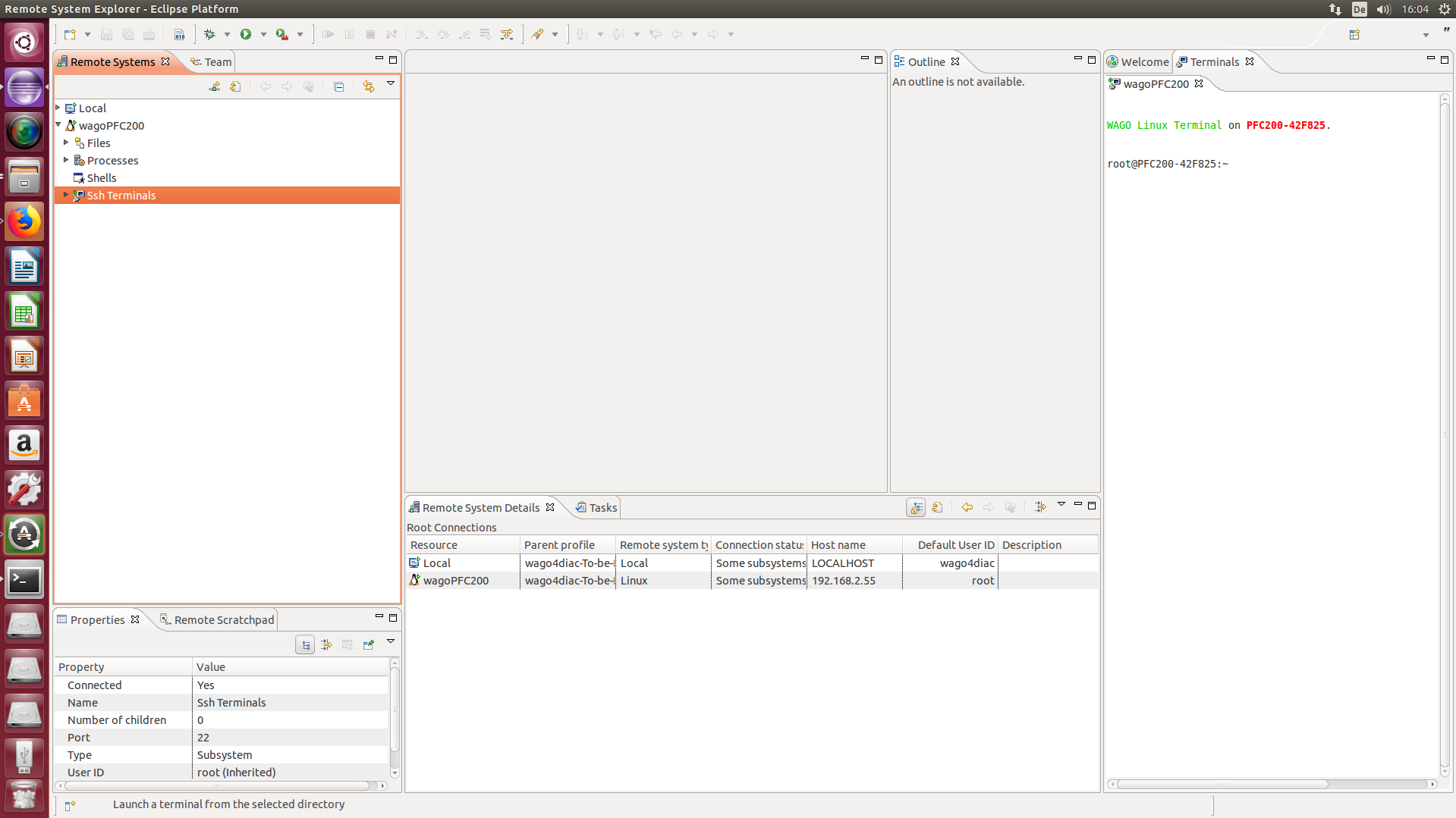

Re: rse; dstore connector service; using port 0 error [message #1807882 is a reply to message #583517] Tue, 11 June 2019 09:27 Go to previous message
I have also tried to follow the instructions. You can see my exact procedure in the videos under the following link. the terminal code for the wago instructions is also attached as a text file.
https://drive.google.com/open?id=1uv9gpyE_wVtjMx2S2ZNDbWvIwM3SFcO5
My problem is the step "A Terminal view should open as well as a Remote System Details view". There, I don't have the same output and can't connect to the wago plc.
I am grateful for any help and support.
best regards
Sezer
ubuntu 14.04 LTS
javac 1.7.0_201
Eclipse Platform
Version: 3.8.1
[Updated on: Tue, 11 June 2019 10:05] by Moderator
