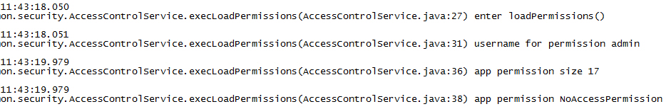

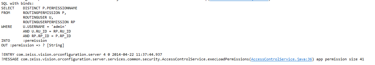

What I found was, that on Jetty I have 41 Permission loaded. The default permissions and the permission which were created by Scout with the new Forms (Permissions_Count_Jetty.jpg).
These permissions are all located in the package (myapp.shared.ui.desktop.form)
On the Tomcat server 7.0.53 only the default permissions are loaded and not those which are located in the package shared.ui.desktop.form. Only 16 Permissions are loaded
A colleague gave me the hint to create an additional permission class, which Scout now generate in the "shared.security" package. This one is also loaded than in the Tomcat server. (Permissions_Count_Tomcat.jpg)
