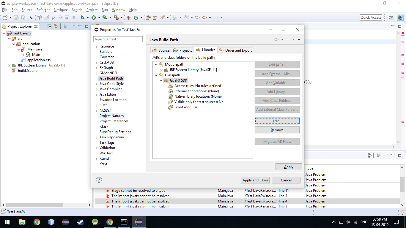

Re: Installed but how do I get it into my project [message #1805397 is a reply to message #1303898] Sat, 13 April 2019 09:30 Go to previous messageGo to next message
I have following versions of software installed on my Windows 10 desktop:
* Eclipse 2019-03
* JavaFx SDK 12
* JDK 12
* JavaFX (e(fx)clipse 3.5.0) from eclipse marketplace
Error
Whenever I create a new JavaFX Project it shows me problem in project:
The import javafx cannot be resolved Main.java
Observation
1) My JavaFX environment variable is set and I'm able to run the JavaFX Application through command line.
2) I've set the Classpath Variable in eclipse with JavaFX bin folder at Eclipse->Windows->Preference->Java->Build Path->Classpath Variables.
3) I've added all the Jars present in lib folder of JavaFX SDK 12 at Eclipse->Windows->Preference->Java->Build Path->User Liberaries by creating new liberary with name of JavaFx.
4) Reinstalled JavaFX (e(fx)clipse 3.5.0) from eclipse marketplace.
5) Uploaded screenshot of JavaFX project->Properties->Java Build Path->Liberaries index.php/fa/35319/0/
Please help me out with this!
Re: Installed but how do I get it into my project [message #1805559 is a reply to message #1805397] Wed, 17 April 2019 08:21 Go to previous message
You need to add the jars to the module path
