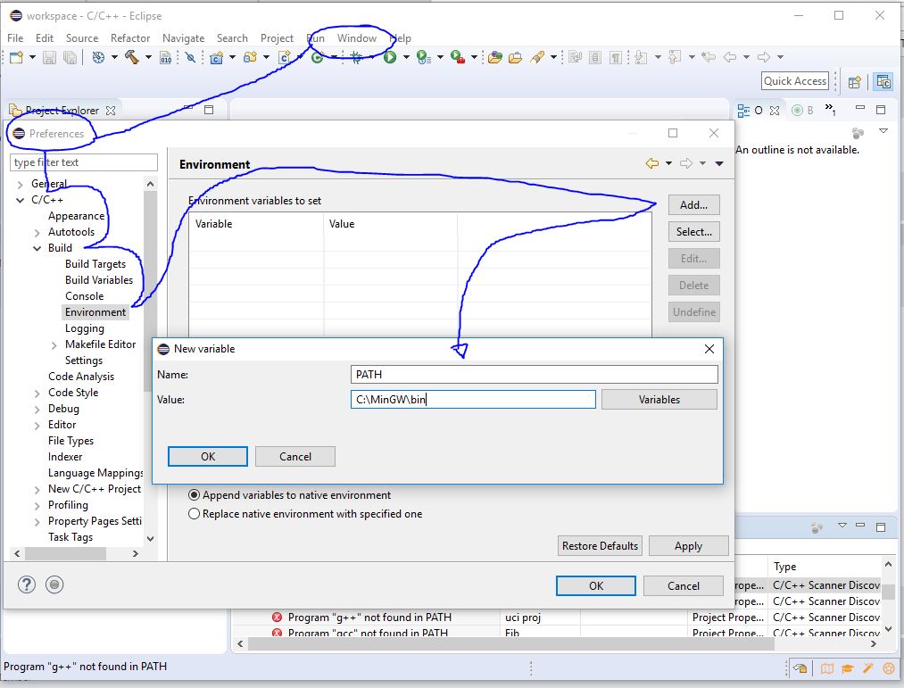

Re: Program g++ and gcc NOT FOUND In PATH!!!!! [message #1576414 is a reply to message #1298610] Wed, 21 January 2015 04:49 Go to previous messageGo to next message
Hi everyone! I have an easy solution:
1) you need to go "windows\preferences\c/c++\build\environment"
2) then just click Add...
3) Set fields with the next values:
Value: C:\MinGW\bin
where "C:\MinGW\bin" is your real path where mingw binaries are stored. (to make sure that you set the right path just go to this directory and find gcc.exe or g++.exe. if you find it it's ok.)
4) Choose "Append variables to native environment"
5) Press "Apply" and then "OK"
Now everything works fine.
Hope I helped someone.

Re: Program g++ and gcc NOT FOUND In PATH!!!!! [message #1720631 is a reply to message #1576414] Tue, 19 January 2016 23:43 Go to previous messageGo to next message
Confused How do you do that? How do you get there? So confused.

Re: Program g++ and gcc NOT FOUND In PATH!!!!! [message #1750698 is a reply to message #1720631] Sun, 25 December 2016 22:29 Go to previous messageGo to next message
index.php/fa/27946/0/
A visual aid for John's solution - thanks John.
