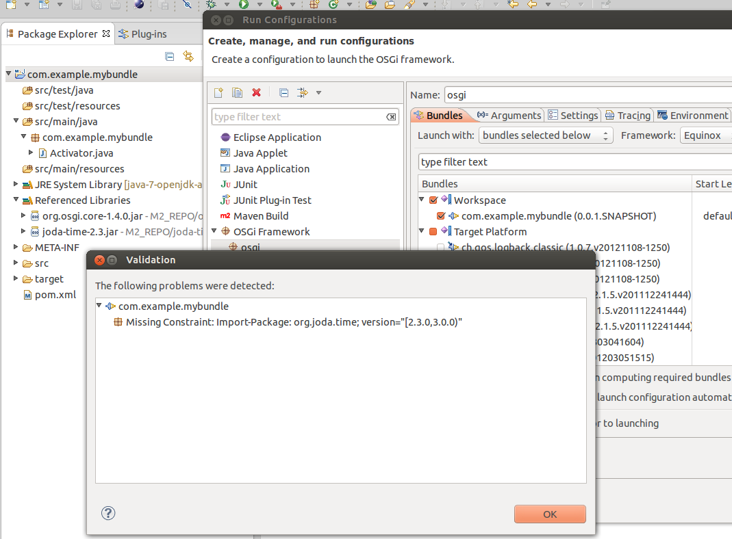

i like to develope bundles with eclipse and maven (maven-bundle-plugin). A lot of Maven-Dependencies are already OSGi-Bundles. So my question is, how can i add them to my run configuration inside the Eclipse IDE to run and debug an bundle?
The picture shows the problem.

I believe this is something solved, in part, by the Tycho project. http://eclipse.org/tycho/
