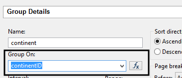

Marc,
For dynamic grouping i was actually thinking to the native group expression. Usually, in this expression we set a simple stuff such image below.
index.php/fa/17851/0/
But in your case, if all column levels are present in the dataset it could be something like:
//Firstly we have to find out which column should be grouped
var groupingField="yearField";
if (params["level"]==2){
  groupingField="monthField";
}else if (params["level"]==3){
  groupingField="weekField";
//now we actually return the grouping value
row[groupingField];
Though there are many other options to achieve this, solving the problem in the before open script of the dataset as you suggested, or through a computed column of the dataset would also be fine.

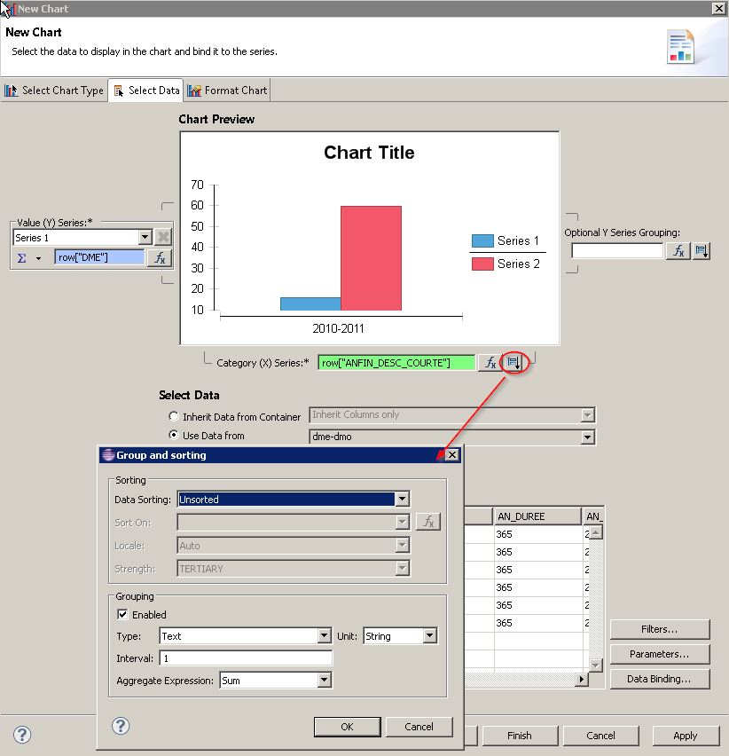

Re: report calling themselves [message #1278706 is a reply to message #1278600] Thu, 27 March 2014 14:42 Go to previous messageGo to next message
I don't have such a grouping option, here is what I have: see attached image
I am in the chart creation screen and the grouping option I have is called "Grouping and sorting" and I can't put any javascript expressions in it as per your example.
https://www.eclipse.org/forums/index.php/fa/17853/
I am startled
Marc

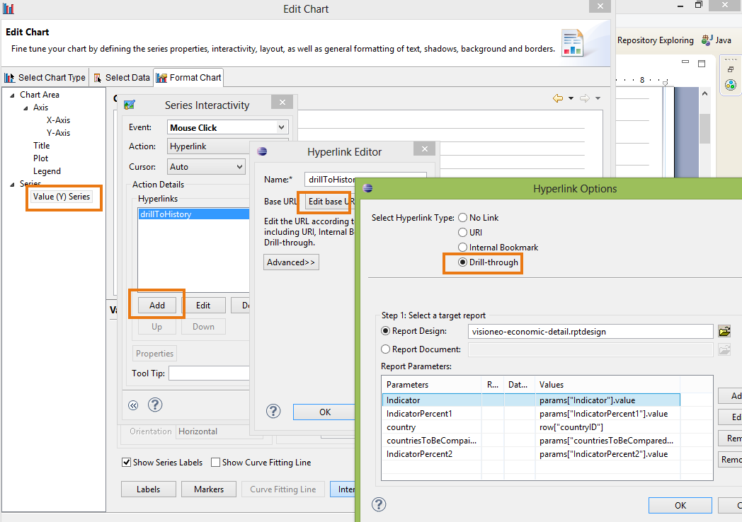

Re: report calling themselves [message #1279232 is a reply to message #1278744] Fri, 28 March 2014 08:36 Go to previous messageGo to next message
I have done as you are showing, the thing is I don't know how to tell my parameters to change when I click on my bars in my charts.
Like I call the report with &level=1
then, when I click on a year, how do I tell the parameters to change to &level=2&year=2012
then, after that &level=3&year=2012&month=7
As of now, when I click a year, I circle back to the same level in my report.
I am stuck at that level.
Thanks in advance for all your PRECIOUS help.
Marc
  • Attachment: Chart.jpg
    (Size: 151.14KB, Downloaded 259 times)
[Updated on: Fri, 28 March 2014 08:43] by Moderator
Re: report calling themselves [message #1279778 is a reply to message #1279232] Sat, 29 March 2014 03:56 Go to previous messageGo to next message
By looking at your screenshot, may be the "niveau" report parameter should be defined as Integer datatype it would be easier to handle.
That said, in this drillthrough action we should drill to the next level by sending an expression for "niveau" such:
params["niveau"].value+1;
For other drillthrough parameters
- if it is the current level we should send the clicked value of the chart
- otherwise we send the existing report parameter value. For example with "annee" parameter, if we also have a column "annee" in the dataset it would be:
if (params["niveau"].value==1){
  row["annee"];
}else{
  params["annee"].value
and so on for other drillthrough parameters. I hope it helps

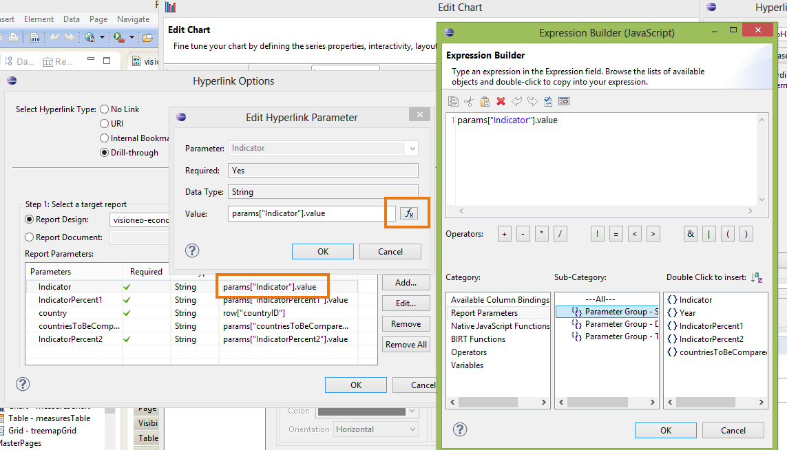

Re: report calling themselves [message #1281147 is a reply to message #1279778] Mon, 31 March 2014 08:34 Go to previous messageGo to next message
donino donino wrote on Sat, 29 March 2014 03:56
HAHA! That is where I am stuck.
Where should this code go? In the script section of the base url script? in the mouseclick section? I can't code javascript in there because I now have a drill through action that prevents me.
[Updated on: Mon, 31 March 2014 08:36] by Moderator
Re: report calling themselves [message #1281263 is a reply to message #1279778] Mon, 31 March 2014 12:17 Go to previous messageGo to next message
Re: report calling themselves [message #1281275 is a reply to message #1281263] Mon, 31 March 2014 12:39 Go to previous messageGo to next message
Marc Arbour wrote on Mon, 31 March 2014 12:17
This code goes in the value expression of your drillthrough parameter "niveau". See this example, by editing or double-clicking a drillthrough parameter it displays an expression builder. Most of the time we just map it to a report parameter or a column binding, but we can also build complex expressions with loops, conditions, declare variables etc. In your case, just increment report parameter "niveau".
Let me know if it helps.
index.php/fa/17867/0/
[Updated on: Mon, 31 March 2014 12:56] by Moderator
