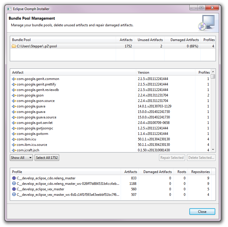

<blockquote cite="mid:lfpsrh$q8k$1@xxxxxxxxe.org" type="cite">I
also experience that the cashed plugins for the TP are some times
corrupt and I need to clear the folder,</blockquote>
That is a very severe concern regarding the use of bundle pools!
When one bundle gets corrupt all profiles that include it are
unusable and must be deleted together with the entire pool. To be
honest, this can (easily) happen to not-shared installations, too,
but then the effect is kind of "more local". To increase the trust
in our bundle pools I've recently created a very cool *Bundle Pool
Manager* that is available in the Oomph Installer dialog and in the
Oomph-installed IDE Preferences dialog:<br>
<br>
<img src="http://www.eclipse.org/forums/index.php?t=getfile&amp;id=17722" alt=""><br>
<br>
It detects all pools and scans them for unused or damaged artifacts
and let's you selectively delete (garbage collect) or repair
(re-download) them. Later I plan to add functions such as
re-locating or splitting up pools. I hope that with this visibility
and managebility bundle pools can escape their, well, shadow
existence. They're so powerful.<br>
<br>

>> I also experience that the cashed plugins for the TP are some times
> That is a very severe concern regarding the use of bundle pools! When
> one bundle gets corrupt all profiles that include it are unusable and
> must be deleted together with the entire pool. To be honest, this can
> (easily) happen to not-shared installations, too, but then the effect is
> kind of "more local". To increase the trust in our bundle pools I've
> recently created a very cool *Bundle Pool Manager* that is available in
> the Oomph Installer dialog and in the Oomph-installed IDE Preferences
> dialog:
Wow , x-mas is early this year!
> It detects all pools and scans them for unused or damaged artifacts and
> let's you selectively delete (garbage collect) or repair (re-download)
> them. Later I plan to add functions such as re-locating or splitting up
> pools. I hope that with this visibility and managebility bundle pools
> can escape their, well, shadow existence. They're so powerful.
