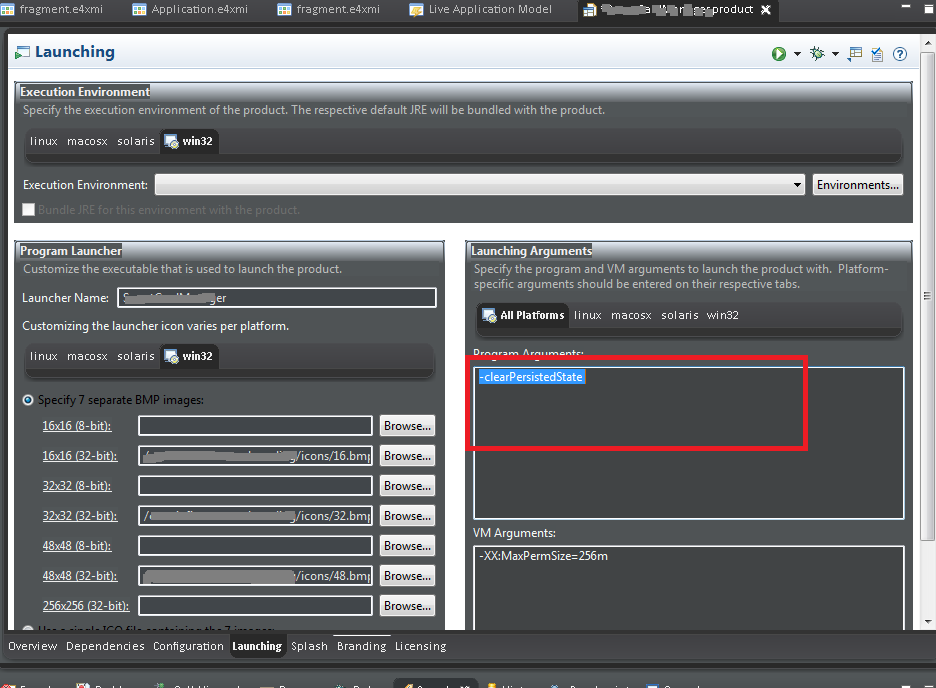

Open you product and you can add this option under Launching Argument. See the below image.
index.php/fa/17698/0/
  • Attachment: Untitled.png
    (Size: 48.62KB, Downloaded 3199 times)
