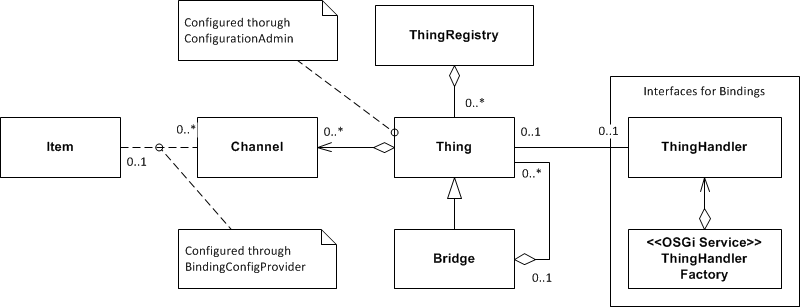

All, I would like share with you a proposal for a major refactoring of how bindings are implemented in order to solve a few issues we had in the past:
The Item concept in the Eclipse SmartHome framework is great to describe the functionality of different devices and services and to simply integrate and connect different types of those. However, when it comes to the representation, configuration and pairing of 'physical' devices, the Item concept does not fit. There is no direct information how many physical devices are connected to the framework and no common way to configure, pair or add them. Configuration is typically done inside the binding configs.
Instead of enriching the Item concept with meta data for physical devices, we propose to introduce a new concept in Eclipse SmartHome. The main entity of this new concept is called "Thing" (right, we are talking about the Internet of Things, aren't we?). A Thing is a physical device or a service that is connected to the Eclipse SmartHome framework. Things have Channels, which can be bound to Items. Moreover a Thing has a status (online, offline, etc.), meta properties (vendor, version, etc.) and a configuration. The configuration is managed through the OSGi ConfigurationAdmin. A Channel contains information about which Item type can be bound and contains a configuration, too.
Things are normally connected to the framework through some kind of peripheral like a USB stick or an IP gateway. We call this thing a Bridge. A Bridge contains or connects other Things.
All Things available in the framework are registered in the ThingRegistry. The ThingRegistry is managed, which means that there is a staging for Things: They are not automatically added and available, but they are only "proposed" by bindings and need to be approved (by the user or some other instance) in order to be added to the ThingRegistry. A Thing always belongs to one binding. Things can NOT be subclassed or implemented by bindings.
Instead, bindings work with Things by implementing ThingHandlers. A ThingHandler automatically receives command and update events, which are sent to Items bound to the channel of the Thing. Moreover the ThingHandler has access to the Thing and its Configuration. To simplify working with OSGi configuration admin, Dictionaries are automatically transformed into Java objects, which classes can be defined by the binding. Here is a class diagram, which shows the relation between these new concepts:
index.php/fa/17679/0/

Re: RfC: New Thing concept [message #1266726 is a reply to message #1266584] Fri, 07 March 2014 17:05 Go to previous messageGo to next message
This looks like a nice approach! Is there a plan to allow SmartHome to act as an aggregator that can report data to an external entity? It seems like SmartHome could be used as a proxy for interacting with registered devices -- abstracting the complexity of how they are connected and keeping some of the control logic local. I would be interested in integrating our project (sitewhere.org) with SmartHome so that the data, integration, and analytics for multiple systems can happen in the cloud.

Re: RfC: New Thing concept [message #1267638 is a reply to message #1266726] Sun, 09 March 2014 05:50 Go to previous messageGo to next message
Derek,
What you are probably looking for is a "persistence service" - these are the concept in SmartHome to export data to cloud services for further processing. You can find a nice example e.g. at http://airvantage.github.io/blog/2013/08/08/openhab-with-airvantage/.
Kai

Thanks for your good questions - let me try to answer them one by one:
1. Only one at a time; but I could imagine that a binding can provide an RS232-bridge or an IP-bridge and provide the same kind of Things behind these; but one concrete Thing is obviously always attached to only one bridge.
2. Good question; I think in general, it should not be necessary. To cater for cases where this is helpful, I would assume that we will also expose them.
3. Things do not communicate with each other - all communication is done through items as it is today. So you can have 2 things bound to the same item or you can have two items and define a rule that decides about the communication flow.
4. Yes, the idea is to delegate a lot of this to the ConfigurationAdmin; so all you do is to create a new configuration and the factories will create a bridge or thing instance for you. The only dependency is the one from a bridge to all connected things - as the bridge would create the new thing configurations, this is easy to deal with.
5. The Channel names would be chosen by the ThingHandler implementation.
6. No subclassing, because it would not allow the generic factory approach. What you can do though is to subclass the configuration classes for your things; so you can support different device types by simply providing different sets of configuration.
7. Not sure, if I understand the question. The items will remain as they are - so there will still be Rollershutter Items. And there will be devices (=Things) that provide a rollershutter functionality (=Channel). What you can do is to bind your item to such a channel. So channels are on the same level of abstraction like items; but they represent the "physical" world, while "items" are the "modelled/virtual" world. The advantage of this split is that you can assign an item to a different channel (bind it to a different hardware) at any time and keep your rules and UI definitions untouched.
8. Well, channels are a containment of Things, so in some way they are part of it. They can vary in number and thus are not hard coded.
9. Events on the bus are always for items. But there can be convenience methods in a ThingHandler that allow to post events for a channel (which is then automatically mapped to the according item, if any is bound to it).
10. Yes, a different configuration of the Thing can result in different Channels being supported by it. But besides this, "Channel" are anyhow not active per se, but only if they are bound to an item. So the user can also simply decide to ignore a channel and not use it.
Kai

Re: RfC: New Thing concept [message #1269092 is a reply to message #1268205] Tue, 11 March 2014 07:17 Go to previous messageGo to next message
Let me try to answer all three questions at once:
"Thing" instances do not really hold any logic or code - they are a concept to have a handle for components that can be added or removed from the system and which bring functionality (=channels) that can be represented by items. Things do not directly offer items as they should not decide on their name, but the user should do this. That's why there are the channels.
Things and channels are not meant to interfere with any current "operational" concepts and behaviours; events only exist for items and items are what is used in rules, UIs etc. The ThingHandler only holds the "driver logic", i.e. the code that was contained so far in the XXXBinding classes - and it brings some structure on how to implement it and a couple of helper methods and other convenience stuff.
Let me add that the Thing concept is mainly meant for "higher-level" bindings, i.e. where you deal with clearly defined devices/services. So the TCP binding (likewise the serial, http and exec binding) will not be a good match; but nobody forces these low-level bindings to use the new concepts (with the side effect, that there won't be any generic UI and pairing support for them, but that is imho acceptable).
Kai
Re: RfC: New Thing concept [message #1269287 is a reply to message #1269092] Tue, 11 March 2014 12:54 Go to previous messageGo to next message
I'm finding it hard to understand the new proposal, so +1 on calling things what they are (devices/services, etc).
Shouldn't there also be a BridgeHandler interface which can be implemented by the bindings?
For the nikobus binding for example, I have one device linked to a serial port which acts as a gateway to a bus with multiple switch modules and switch buttons.
So in the new terminology I guess that the gateway would be the Bridge and the Switch Modules and Switches would be Things.
As all the communication to the switch modules has to go through the Bridge and there should really only be one process coordinating all the read/write operations to that serial port, to me it would make sense to implement this logic in the BridgeHandler.
For the DMX binding, the artnet or OLA interface could be a Bridge and then the actual devices like a RGB strip could be a Thing.
But also here, all communication to the DMX universe should be handled by a single process, so having a BridgeHandler would help here too.
Davy

Re: RfC: New Thing concept [message #1269954 is a reply to message #1269397] Wed, 12 March 2014 06:53 Go to previous messageGo to next message
I´m working with Kai at the Deutsche Telekom and was involved in the development of the 'Thing' concept. So i can also answer some question in order to help Kai a litte bit here.
Davy, you are right, the Gateway would be the bridge and the switches would be Things. Things, that are connected through a bridge, always have access to their Bridge. Moreover there is also a ThingHandler for the Bridge (we might call it a BridgeHandler). The ThingHandlers of the 'switch' Things have access to their according BridgeHandler. So you can delegate the handling of commands to your BridgeHandler. At the end its up to the binding developer how he wants to implement it.
Regarding the 'Thing' interface, it might be better, to have concrete subinterfaces for 'Device' and 'Service' that inherit from 'Thing'. So there could be a DeviceHandler and ServiceHandler.
Later, I will post two sample ThingHandlers for Philipps HUE here, so that everyone might get a better idea how a concrete ThingHandler implementation could look like.

Re: RfC: New Thing concept [message #1270261 is a reply to message #1266584] Wed, 12 March 2014 15:20 Go to previous messageGo to next message
Thanks Dennis, that already clarifies a lot. I have some more questions you may be able to shed some light on..
How are bridges linked to bindings? More specifically, how/by whom are things and bindings created and in which sequence?
Are they configured in a fixed sequence, e.g. bridges always before things?
Is this sequence respected when binding bundles are stopped/started?
What is the purpose of the 'staging' of things before they are added to the ThingRegistry? If a thing was added by a binding, but not configured by a user, it would have no impact, right?
Re: RfC: New Thing concept [message #1270904 is a reply to message #1269954] Thu, 13 March 2014 15:57 Go to previous messageGo to next message
Dennis, Kai
Cfr the post on the BridgeHandler + the code snippets:
How is the relationship between a Bridge and BridgeHandler established? The code is clear, but in my understanding the BridgeHandler is a kind of "upper" bridge, that sits on top of the "lower" bridge, with the lower bridge taking a kind of technology/hub approach if necessary, thereby doing stuff like multiplexing data.
Cfr previous discussions on the OH forum, how would communication hubs fit in the Bridge world? e.g separate technology bindings like TCP, serial, bluetooth, etc from the rest. How can bindings, via their BridgeHandlers share Bridges?
Related to that, if you have various Things that talk to the same remote server, and for example share a single TCP connection to do so (because, for example, the remote device only accepts a single TCP connection), how will traffic be separated? what class is responsible for that... not clear to me.
Can BridgeHandlers be subclassed to allow for technology fail-over mechanisms, e.g. getBridgeHandler returning a bridge in function of the technology available? or, there is a base TCPBridgeHandler for example, that is subclassed to implement this multiplexing stuff if required?
Lastly, it is not very clear to me right now what stuff has to go in the ThingHandler, and what stuff needs to go into the BridgeHanlder. For some bindings this will be a though choice to be made, with possibly either one of th classes ending up being very "light"
K
Re: RfC: New Thing concept [message #1270911 is a reply to message #1270904] Thu, 13 March 2014 16:21 Go to previous messageGo to next message
Kai,
I like this concept, as it provides a layer of abstraction we sorely need. I've been thinking about how to broach this, and this is a perfect opportunity.
Most of the items we access fall into some classification (light switch, temperature sensor, thermostat, shutter control, etc), though we have been too often directly passing along the APIs to these devices instead of generic operations. For example a basic light switch would have the two operations;
- on
- off
Basic dimmers would have;
- increase(amount)
- decrease (amount)
Specializations could include;
- status (on/off) //for plain switches
- status (% illumination) //for dimmers
- dimmingRate (int) // for dimmers
Any vendor's special operations could be added in an additional specialization.
The same goes for virtually all of the items we have that are represented by more than one vendor or model.
This way, the rules would be more reusable and we could create libraries of rules that would require little to no rework.
Re: RfC: New Thing concept [message #1271073 is a reply to message #1270911] Fri, 14 March 2014 03:21 Go to previous messageGo to next message
let me try to answer some of the last questions:
Davy: Things and Bridges are created through entries from the configuration admin. A 'ThingHandlerFactory' is called for each stored entry in the configuration admin. Unfortunately there is no specific order. But the binding developer has full control of the Thing creation process by implementing an own 'ThingHandlerFactory'. The following snippet shows a simple factory for the HueBridgeHandler which inherits from a BaseThingHandlerFactory, which already encapsulates a lot of complicated stuff around the configuration admin:
public class HueBridgeHandlerFactory extends BaseThingHandlerFactory<HueBridgeHandler, HueBridgeConfiguration> {
    protected HueBridgeHandler createThingHandler(HueBridgeConfiguration configuration) {
        return new HueBridgeHandler(configuration);
    protected void removeThingHandler(HueBridgeHandler hueBridge) {
        // nothing to do
According to staging. You are right, the idea is, that the user can control which Thing he wants to add to his system. But this might only taken into account in pairing UIs. In openhab the user defines it Things statically, so that there is no staging at all.
Karel: As Kai already mentioned, the Thing concept is for 'high-level' bindings. TCP, serial or blutooth binding are examples for more low-level bindings. The Bridge does not represent the protocol, it represents something like a Gateway or USB stick. But it could be possible to define base classes for common Thing or BridgeHandlers. For example you could have a HttpThingHandler, which already sets up an HttpClient, that can be subclassed for all Things or Bridges, that uses Http for communicating with their devices. From the model point of view, it is also possible to have hierarchies of bridges, because also a Bridge could have a parent Thing. But this makes it really complex.
Re: RfC: New Thing concept [message #1271093 is a reply to message #1271073] Fri, 14 March 2014 04:38 Go to previous messageGo to next message
I am looking forward to move some of the bindings to this architecture.
That being said, will both models (e.g. old and new) co-exists at a given point in time? moving the bindings into the new model will take quite some time IMHO, certainly the ones that are the result of reverse-engineering prop. protocols
Kai, any preliminary timeline you have in mind for "2.0"?
Re: RfC: New Thing concept [message #1271112 is a reply to message #1271093] Fri, 14 March 2014 05:47 Go to previous messageGo to next message
@Davy: Just one addition regarding the "stating": This is to also allow bindings to do auto-discovery. Imagine e.g. IP cams that are found through UPnP. The user might not want all available cams to be used in his system - so bindings should first only tell that there is something new and the user can decide whether to activate its use or not. This "user acceptance" could be done interactively through a UI, by a specific configuration (acceptXYZ) or by some global configuration setting (auto-accept). Which way we choose in openHAB has still to be defined.
@Will: Please note that this concept is meant to be used for setup, configuration and administration use cases. It is not a replacement for the current "operational" behavior, i.e. the items that are used in rules, sitemaps, persistence etc. So rules will not be impacted by this - they should still use items and not things. Nonetheless, we are working on other new concepts to bring some context/semantics about items into the system, which is meant to simplify and generify rules - so stay tuned for this discussion to be launched soon!
@Karel: Yes, I see them coexisting; the "swiss-army-knife" bindings like tcp, exec, http etc. should definitely stay with their current implementation. Any "higher-level" binding I would want to see migrated to the new concepts for openHAB 2.0, though. As this will take a while, I am planning to look into providing a "1.x compatibility bundle" for openHAB 2.0, so that it should be possible to run (most of) the current bindings as well. Regarding timeline: Well, we have to see how quickly the new bindings will be implemented, so I cannot yet give a date for a first release. Nonetheless, I plan to create a 2.0 branch in the next weeks (latest end of April) and start building snapshot versions of it, so that binding developments can start.
Re: RfC: New Thing concept [message #1378795 is a reply to message #1271112] Sat, 24 May 2014 07:51 Go to previous messageGo to next message
What is the current status of the Thing concept? Is it still in the planning or has the idea been abandoned?
Re: RfC: New Thing concept [message #1383017 is a reply to message #1378795] Mon, 26 May 2014 03:07 Go to previous messageGo to next message
No, not at all abandoned! We are just polishing an implementation of it to soon create a PR from it - current work can be found here: https://github.com/qivicon/smarthome/tree/master/bundles/core/org.eclipse.smarthome.core.thing. I will post here as soon as the PR is ready for it!
Re: RfC: New Thing concept [message #1383890 is a reply to message #1383017] Mon, 26 May 2014 15:18 Go to previous messageGo to next message
Wow, there sure are many things to look at Smile It looks very promising.
Imho, writing bindings is less confusing if you only have to implement interfaces and not extend base classes. It would also be a cleaner decoupling between openHAB/SmartHome if it is strictly interface based. So for me personally, it would look even better if the functionality in the BaseThingHandlerFactory could be moved to the ThinkManager, so that bindings only have to implement the ThingHandlerFactory interface.
Re: RfC: New Thing concept [message #1383940 is a reply to message #1383890] Tue, 27 May 2014 06:20 Go to previous messageGo to next message
Well, you would be free to directly implement the ThingHandlerFactory interface. But the problem with programming against interfaces is that you have to know what you have to do. And our goal is to make life as simple as possible for binding developers and providing an abstract class seems to be the only feasible way here. Or would you have a good suggestion how the BaseThingHandlerFactory could be avoided?
Re: RfC: New Thing concept [message #1383963 is a reply to message #1383940] Tue, 27 May 2014 09:41 Go to previous messageGo to next message
I'll have a deeper look at the code and will try to come up with a more concrete solution.
Re: RfC: New Thing concept [message #1384008 is a reply to message #1383963] Tue, 27 May 2014 15:52 Go to previous messageGo to next message
I tried the code in https://github.com/qivicon/smarthome/tree/thing-refactoring . When I run this, I can register ThingHandlerFactories, but it seems that things themselves are not created. As far as I can tell, the method ManagedThingProvider.createThing is not called from anywhere. Is that part not implemented yet or am I missing something?
Re: RfC: New Thing concept [message #1384009 is a reply to message #1384008] Tue, 27 May 2014 15:55 Go to previous messageGo to next message
This falls under "as soon as the PR is ready for it" - please be patient and give us a bit more time to do finish things and do the PR; I won't answer any support requests until then Smile
Re: RfC: New Thing concept [message #1384012 is a reply to message #1384009] Tue, 27 May 2014 16:01 Go to previous messageGo to next message
No rush. When you said 'polishing' I assumed all the bits where already in place and just needed some minor tweaks or javadoc enhancement.
I'll be back after the PR Wink
Re: RfC: New Thing concept [message #1386200 is a reply to message #1384012] Sat, 14 June 2014 15:02 Go to previous message
FYI: The PR is now available, see https://github.com/eclipse/smarthome/pull/27
Please note that this is not yet ready to be fully used - we will add a few further PRs soon that also provide the config description side of things.
