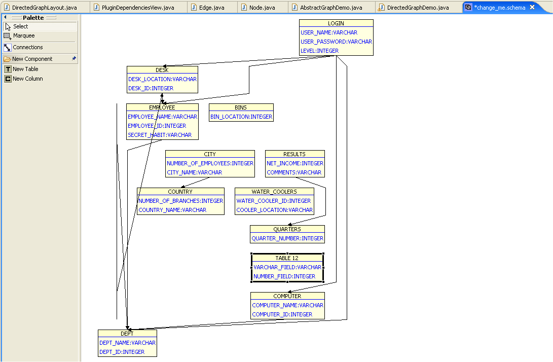

I want to create a GEF editor for hierarchical information, i.e. information
that has a parent-child relationship. The number of nodes is in the range of
10 to 100.
I'd like to use the DirectedGraph for representing the model and
DirectedGraphLayout to layout the nodes and the connections.
I looked at the "Database Schema Diagram Editor" article of Phil Zoio and at
the "org.eclipse.gef.examples.pde.PluginDependenciesView" example in the
"org.eclipse.gef.examples.flow" plugin. Both examples use a DirectedGraph,
the Database Schema editor uses the DirectedGraphLayout and the
PluginDependenciesView uses a combination of GraphVisitors for the layout.
However, both examples suffer from the same problem: when the number of
nodes and connections increase, the routing of the connections gets rather
messy.
This is easiest seen by the PluginDependenciesView, since that uses, in my
current workspace, about 80 nodes and 140 edges (for the
PluginDependenciesView to run, I had to comment out lines 153 to 157, since
the HorizontalPlacement has problems otherwise).

I have found the reason why my graph connections looks 'messy'...
I used the code from the "Database Schema Diagram Editor" and the
DummyEdgeCreator/DummyEdgePart classes.
My graph has disconnected nodes and the Dummy* classes should create dummy
nodes to make the graph connected.
However, when I hane disconnected nodes, the graph layut tends to draw some
edge bottom-to-top, instead of to-to-bottom. The edges are always segmented
top-to-bottom, which causes weird, crossed edges.
You can see this in the Schema Diagram editor:
- Create a new schema, using the 'Pre-created Sample Schema Model'
- Select the toolbar button 'Automatic Layout'
- Select the 'Create a new table' tool in the palette
- Click in the top-left corner of the diagram.
- There is now an edge from table 'DEPT' at the bottom to 'DESK' on the
second rank. On the left hand, an edge segment, spanning 6 ranks is still
drawn top-to-bottom, resulting in a weird crossing.
My graph is quite more complex and has numerous of these upside-down
crossings, hence it looks very messy.
Is there a way around this? Should I not use the
DummyEdgeCreator/DummyEdgePart classes, but use another technique for my
disconnected nodes?
Thanks.

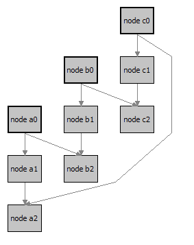

The routing is a little bit smarter nor for long edges. Please look at the
latest code in M5, when it becomes available at the end of next week. You'll
need to checkout draw2d.example project and run DirectedGraphDemo to see how
to use the new bendpoints from the edge class.
Re: DirectedGraph connection routing [message #209309 is a reply to message #209276] Mon, 13 February 2006 16:14 Go to previous messageGo to next message
Originally posted by: mromijn.remove_this_seagull.nl
"Randy Hudson" <none@us.ibm.com> wrote in message
news:dsqm8a$fg2$1@utils.eclipse.org...
> Can you post a picture of the problem?
I have attached an image showing the problem.
It was created with Eclipse 3.2M4 and GEF 3.2M4.
Thanks for your time!

Re: DirectedGraph connection routing [message #209354 is a reply to message #209309] Mon, 13 February 2006 23:28 Go to previous messageGo to next message
Originally posted by: none.us.ibm.com
It looks like there is a bug in the flow example which you have adopted.
When in edge is marked as inverted, you need to walk through its virtual
nodes backwards.
You can (soon) just call edge.getPoints() to get the points back from the
edge. The will be ordered in the naturaly direction of the edge (meaning
upward if inverted).
"Marcel Romijn" <mromijn@remove_this_seagull.nl> wrote in message
news:dsqss7$7jp$1@utils.eclipse.org...
