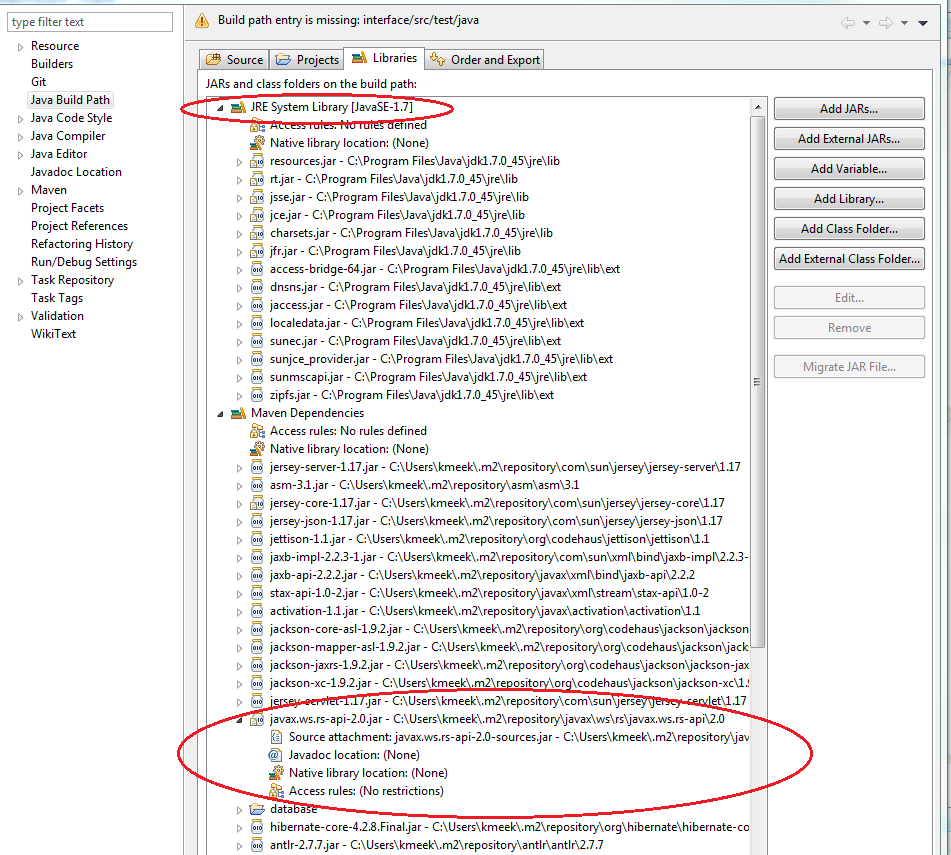

No - I've set up for Java 7 and jaxrs 2.0 as seen in the crop image attached
Also I can open the jar source files (in the maven .m2 directory) and see files there (attached) which has the readEntity there.

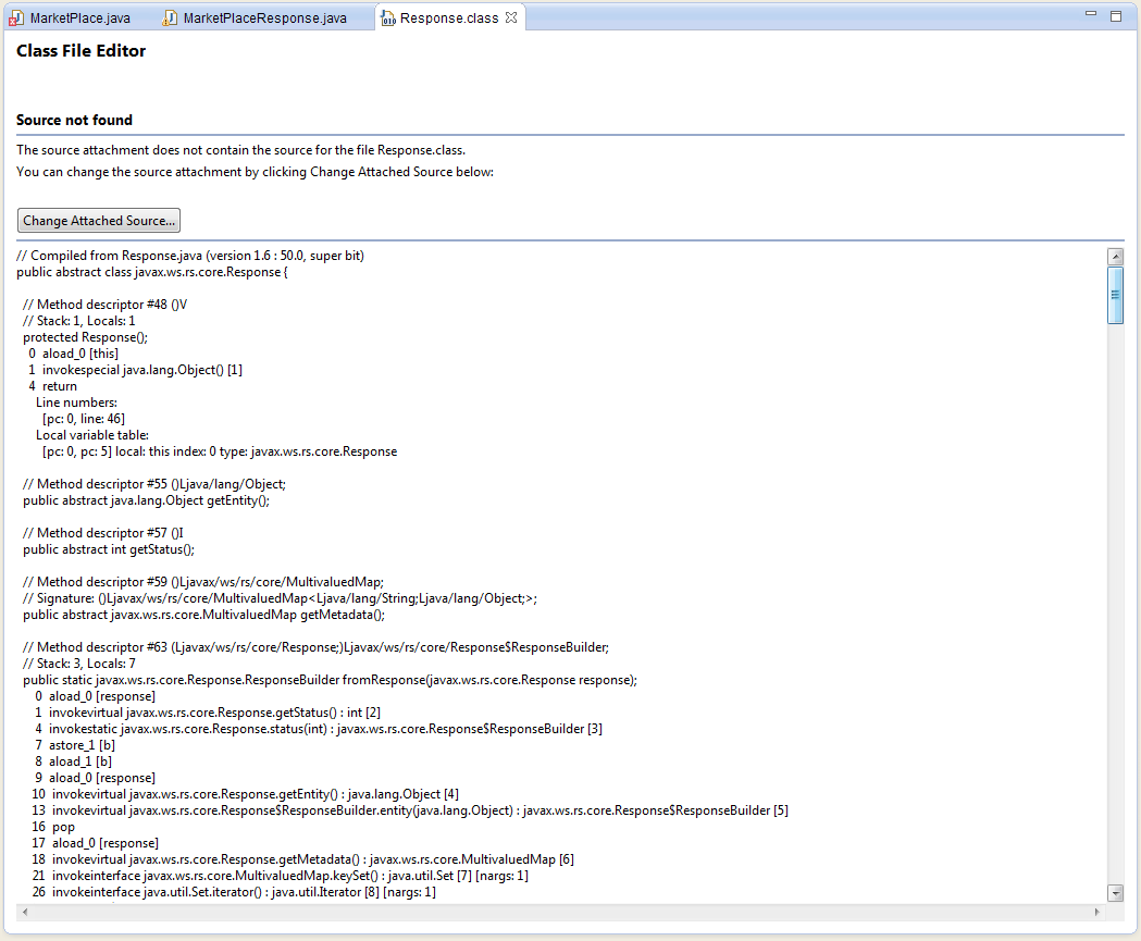

The screen shot of your build path looks correct. What do you get if you put the cursor on the Response class in your code and use F3 to "go into" that class?
Re: Eclipse (Juno) shows an error where there is none [message #1236693 is a reply to message #1236689] Mon, 27 January 2014 16:50 Go to previous messageGo to next message
oohhh - that very interesting. It says it can't find it and is reverting to v1.6 (attached). I guess it's trying to be helpful, but is in effect masking an issue.
K
Re: Eclipse (Juno) shows an error where there is none [message #1236694 is a reply to message #1236693] Mon, 27 January 2014 16:52 Go to previous messageGo to next message
It seems to be complaining about my jersey core 1.17. Let me work on changing that and get back to you.

There's your problem: Jersey 1.17 includes an old version of the Response class. Look at http://grepcode.com/search/?query=javax.ws.rs.Response
So your build path (your Maven dependencies) includes multiple versions of the jaxrs library and Eclipse is picking up the Jersey version "first."
