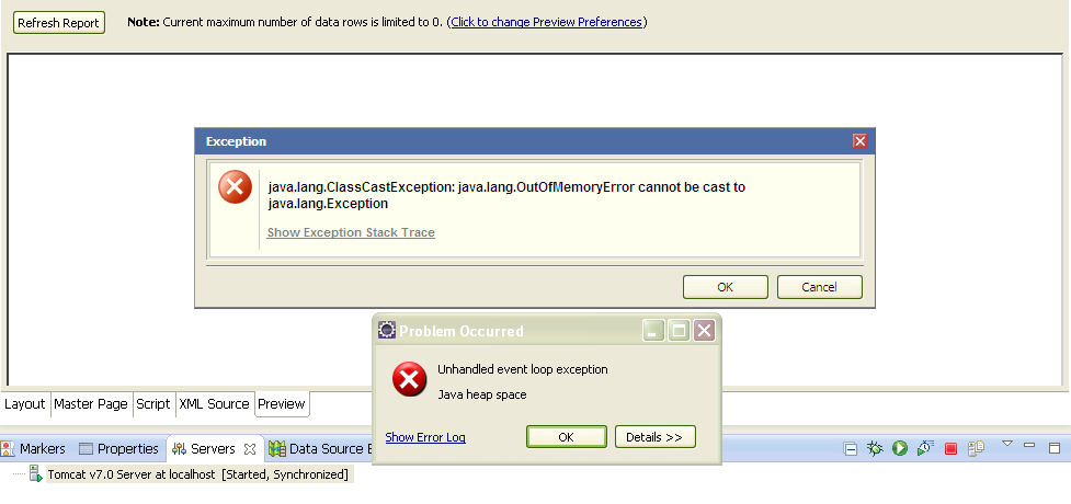

I'm using table to display records from a scripted data set.
My report is working fine for small dataset with records up to 20000. But when My Dataset increases 100,000 records "out of memory error" exception is coming.
I've set the JVM Heap space parameter of my source class to -mx1200m which worked for my source class Smile.
But when the source class is used for scripted data source in Birt report, exception is coming.
Based on the research done on web i tried to set Tomcat JVM heap space to -Xms520m -Xmx1024m and -mx1200m also, unfortunately it didn't work.
This is the exception I'm getting
index.php/fa/17301/0/
Please Help me in in solving the issue.Smile
Thanks in advance. Thumbs Up
