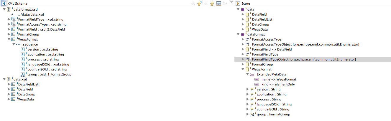

I'm experiencing an issue with my generated ecore model usage. I've generated an ecore model from a xsd file. Look at the following screenshot for xsd to ecore information.
index.php/fa/17263/0/
Now I'm trying to load the following xml file given from the webservice using this xsd schema.

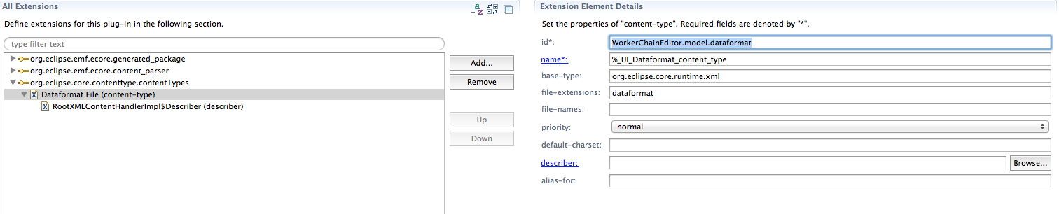

Re: EMF Model, Resource loading issue [message #1242953 is a reply to message #1240917] Mon, 10 February 2014 05:00 Go to previous messageGo to next message
Hello Ed,
my file has "xml" as file extension and you were right, that wasn't configured in the plugin.xml of my model. But now I'm experiencing another problem:
org.eclipse.emf.ecore.xmi.PackageNotFoundException: Package with uri 'wsdl/com/test/wega/service/dataformat/dataformat.xsd' not found.
org.eclipse.emf.ecore.xmi.PackageNotFoundException: Package with uri 'null' not found.
I guess the xsd can't be loaded, because the path given in the resource xml file is webapp relative. Is there a solution for this?
Thanks and greetings,
Sascha

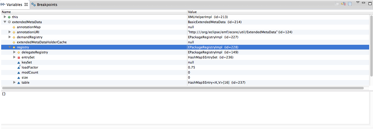

The setExtendedMetaData method is called, but the extendedMetaData object seems not to hold any data in its registry.
index.php/fa/17439/0/
I will check whats going on in the org.eclipse.emf.ecore.xmi.impl.XMLHandler.handleXSINoNamespaceSchemaLocation(String) method.
Greetings,
Sascha
  • Attachment: screeny2.png
    (Size: 62.75KB, Downloaded 3867 times)
[Updated on: Mon, 10 February 2014 09:54] by Moderator

Re: EMF Model, Resource loading issue [message #1252500 is a reply to message #1252325] Fri, 21 February 2014 04:25 Go to previous messageGo to next message
Hello Ed,
ok, I've just tried it the way you've said, but it doesn't work for me. Everything seems to be finde, I have just set the content type identifier in both genPackages and the generated everything. Now the plugin xmls contain the newly generated content type extension point. But as you can see it says file extension "dataformat" but it needs to be xml. I've done the same to my other model and editor and there it says "workerchain" instead of xml. If I change both to xml it does not work, and If I keep the workerchain/dataformat extensions it does not work either. So what am I missing here? Sad When I'm adding xml file extension to both content types, I run into the same old problem again... I can only open one type of editor with xml files, running both editors in my application leads to problems.
Another thing I have mentioned is that the "org.eclipse.emf.ecore.extension_parser" extension point is not generated anymore.
index.php/fa/17528/0/
Greetings,
Sascha
[Updated on: Fri, 21 February 2014 05:08] by Moderator

yes this method is involved and I've tried to debug what's going on inside this method. I guess you're right, it seems that my xml input files are conform. What really distinguishes one type from another is not the namespace i think (workerchains only have default namespace declarations) its more the structure of the xml files. workerchains always have "process" named rootelement, the dataforms always have a different unique named element)
<process xmlns:xsi="http://www.w3.org/2001/XMLSchema-instance">
</process>
The dataformat xmls do have a unique namespace, but the workerchains do not.
I'm always running into this last part of the method:
if (rootElementName != null && isMatchingNamespace(rootElementNamespace))
          boolean elementNameMatched = false;
          if (elementNames == null || elementNames.length == 0)
            elementNameMatched = true;
          else
            for (String elementName : elementNames)
              if (rootElementName.equals(elementName))
                break;
          if (elementNameMatched)
            result.put(VALIDITY_PROPERTY, ContentHandler.Validity.VALID);
Where this part is true (elementNameMatched = true), nameSpaceMatching was true because of null namespace. I'm wondering why elementNames is always empty?
So is there a way to fix this problem? I feel like i'm in a dead end. :/
Greetings,
Sascha
[Updated on: Mon, 24 February 2014 06:48] by Moderator

 <extension point="org.eclipse.core.contenttype.contentTypes">
      <!-- @generated workerchain -->
      <content-type
            base-type="org.eclipse.core.runtime.xml"
            file-extensions="xml"
            id="WorkerChainEditor.model.workerchain"
            name="%_UI_Workerchain_content_type"
            priority="normal">
         <describer class="org.eclipse.emf.ecore.xmi.impl.RootXMLContentHandlerImpl$Describer">
            <parameter
                  name="elementNames"
                  value="process">
            </parameter>
         </describer>
      </content-type>
   </extension>
I've just defined a "elementNames" Parameter in both of my content type definitions. They are automatically used to init the RootXMLContentHandlerImpl class. Now the content type methods work as intended. =)
