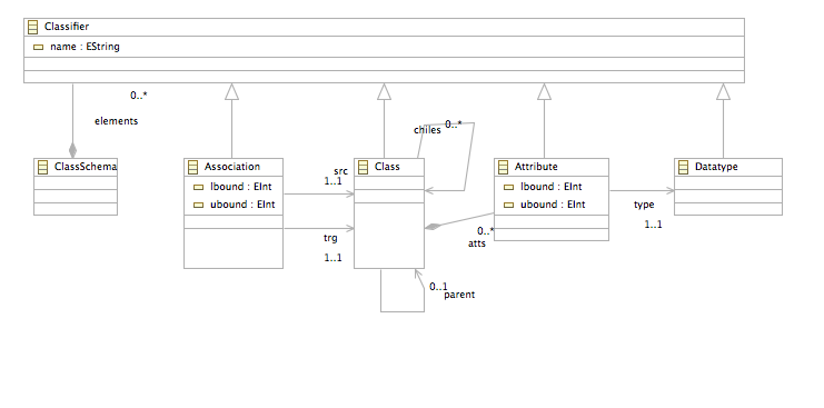

I would like to union two sets of different classifier with OCL:
for the code below:
Class.allInstances()->union(Attribute.allInstances()) //Class and Attribute are two Classes defined in Ecore
it returns :
Unresolved Operation 'Set(myOO::myOO::Class)::union(Set(myOO::myOO::Attribute))'
How can I do this?
PS:
1- In other word, it seem that OCL treats SET as a SET<T>, unlike the concept of set in set theory in mathematic that the type of the set members is not concerned.
2- Ecore diagram is attached

I found a solution to my problem!
my assumption that the sets are typed over their members in OCL is true. so it seems that OCL can not union two sets of different types!
so I cast two set to be of the same type and then union them.
In my example I cast them to the "Classifier" class and then union as below (you might need to see the ecore diagram file in my previous post to get this) :
Class.allInstances()->collect(oclAsType(Classifier))->union(Attribute.allInstances()->collect(oclAsType(Classifier))) //oclAsType do the casting and collect apply this operation to each member.

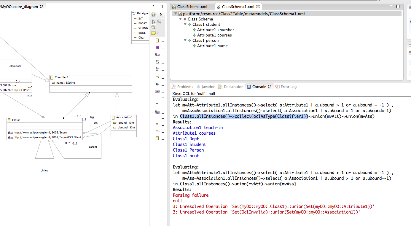

I installed the last version of Eclipse 4.3.1 and ocl for ecore 3.3.0
I tried to union two classes which are children of the same parent, but still I need to cast explicitly one of them to its parent (by using oclAsType operation) to have my OCL code running in OCL in xtext console.
I am wondering if this is the normal behaviour of the OCL?
to make my question more explicit, Does OCL treat SETs as pure SETs or it treats them as SET<T> where T is the type of the including members? I assume the latter is the case? right?
For more details, Please look at the attached screen shot; OCL codes and the Ecore diagram are visible in that picture: I highlighted the part I mean I need to write explicitly; As you see removing the oclAsType in the second query would result an error.
