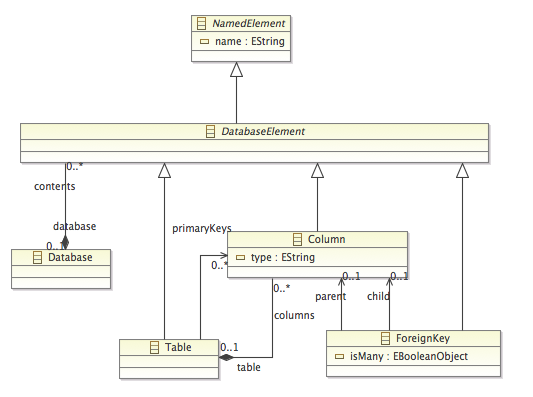

I use DB.ecore of the Epsilon project from this link here (see attached diagram plz)

The only difference I see in the ecore file for the "columns" and "primaryKeys" is that the former is byVale and the latter is byRef for the class Table. Does this cause this weird behaviour?
I attached the diagram of the ecore file for better presentation.

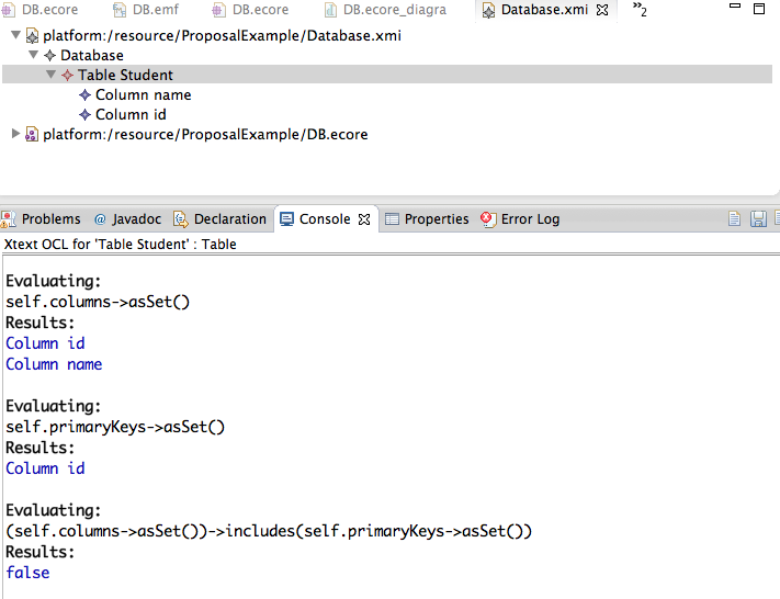

Please look at the attachment of this post. I took the screenshot of the OCL queries and the results I am getting.
Am I doing something wrong here?!
