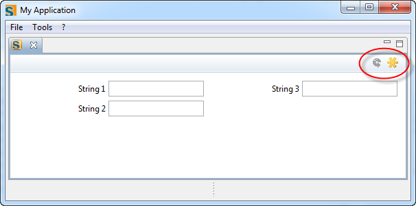

We are evaluating the possibility of adding ToolButtons in a Scout Form. Here some intermediate results to check if there is any interest.
The current solution can be used without any Scout runtime modification. It is realized with custom code to overload some functions (Form in the scout model, SwtEnvironment...). We haven't published the code anywhere, but I am happy to share it, if someone wants to have a look at it.

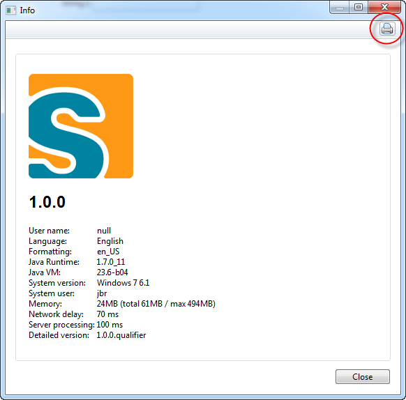

SWT rendering engine
For now we have added some code to be able to render it in the SWT (views and dialog):
index.php/fa/17135/0/
index.php/fa/17136/0/
