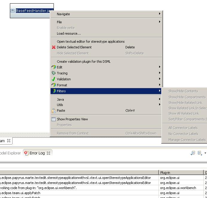

I'm trying to create a class diagram using reverse engineering. I am able to create a model file (.di) and can open the file in Model explorer after doing the discovery of all Java artefacts. When I create a diagram on root model and drag-drop classes, they appear on the diagram but none of them have any attributes/methods visible, and when I click on Filters(right click on class -> Filters) everything is greyed out there (all options of Show/Hide contents are disabled)> Please refer attached snapshot.
I am also not able to see association/links between the classes if I drag-drop couple of more classes.
Please suggest.
