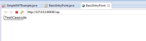

Re: Zest plugins for RAP [message #1212867 is a reply to message #1212272] Tue, 26 November 2013 21:57 Go to previous messageGo to next message
I am able to use the libraries, now my compilation errors are resolved...
I have an another issue, after creating the nodes and relationships and also applying algorithm, i am not able to update the graph in the parent composite of my RAP
Please find the snippet
currentLayoutAlgorithm.applyLayout(layoutEntities, layoutRelationships, 0, 0,
parent.getClientArea().width - 30,
parent.getClientArea().height - 17, true, true);
Regds
Rahul
Re: Zest plugins for RAP [message #1214533 is a reply to message #1212867] Wed, 27 November 2013 13:51 Go to previous messageGo to next message
Eureka, finally my code works.....i am able to see my nodes and relationships in RAP...thanks to all who had helped me out in this, especially to : Arnaud MERGEY
I have one problem now.....which is w.r.t layout of Grid Data
Please let me know how can i arrange and visualize these nodes in a better format
Regds
Rahul.
