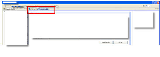

Our application shows multiple forms within the main application window. See attachment.
The forms are defined with DISPLAY_HINT_VIEW.
The SWT client shows all forms with tabs so the user can switch between the showed forms.
The same works if the client is shown as RAP client.
Unfortunately this behavior is not reflected by SWING. The SWING client only shows one form, if 'opening' a new form, the former form will be coverd by the new one.
Does anyone have a hint, to get SWING presenting forms with DISPLAY_HINT_VIEW the same way as they are presented with SWT and RAP client?
