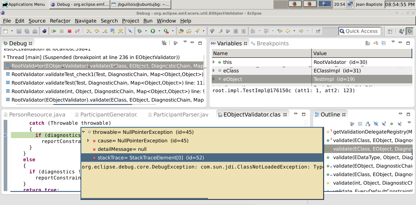

Re: OCL Validation outside of eclipse [message #1125560 is a reply to message #1125532] Fri, 04 October 2013 12:47 Go to previous messageGo to next message
I get this exception while stepping with the debugger in the EObjectValidator class line 237.
At the end (from my main class), the end result is the same as before.
What other info can I provide you on this problem to help you helping me?
Best Regards,
PS: Thx for the bug, i read its description and I agree that having more info when a validation fails because of missing entires in classpath would bgreat.
Re: OCL Validation outside of eclipse [message #1125610 is a reply to message #1125560] Fri, 04 October 2013 13:52 Go to previous messageGo to next message
An exception is the first line of a diagnostic; where is the rest of it?
org.eclipse.debug.core.DebugException: com.sun.jdi.ClassNotLoadedException
is a very odd exception; it suggests that the debugger is malfunctioning
so the context may be very revealing.
See
http://stackoverflow.com/questions/1367730/how-do-i-deal-with-a-classnotloadedexception-while-debugging.
Ed Willink

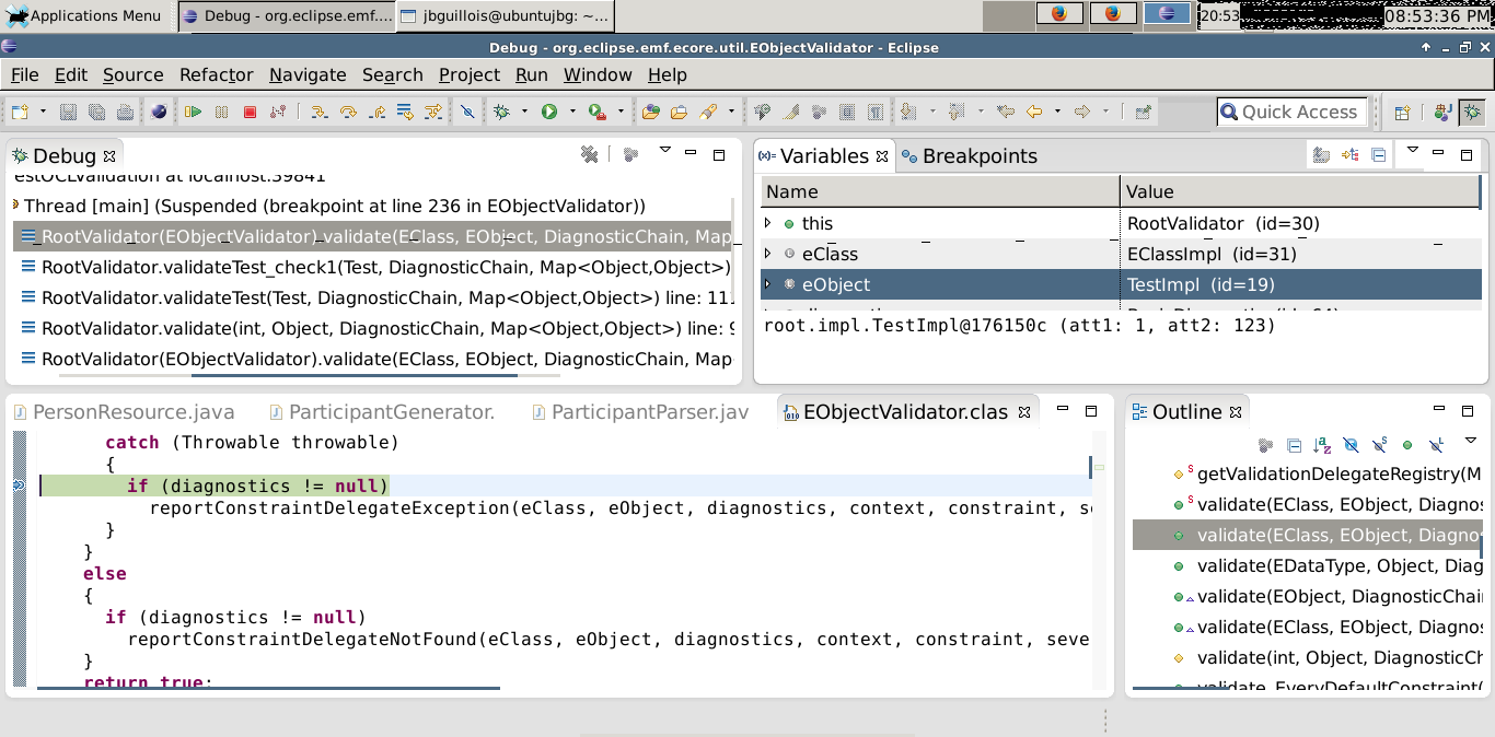

Re: OCL Validation outside of eclipse [message #1127493 is a reply to message #1125532] Sun, 06 October 2013 14:57 Go to previous messageGo to next message
Hi Ed,
Please find attached two screenshots of my current eclipse state where you will see the stacktrace i talked about.
I don't know what information I can add to help you...
Thx for your help,
Best Regards,

Re: OCL Validation outside of eclipse [message #1129603 is a reply to message #1129300] Tue, 08 October 2013 16:21 Go to previous messageGo to next message
Hi Ed,
Thx for your email.
I have carefully read the ForumNetiquette as you suggested.
Nevertheless, I have provided you with a zipped project containing the required files for demonstrating my problem which, since the beginning, is about getting some help on how to initialize the OCL framework. I am still struggling at this and was hoping to find some help in doing such an initialization (which, in my opinion, does not seem to be that special) in this forum.
I have added the two previous screenshots for illustrating the exception I have encountered as no stacktrace is being printed anywhere (as far as I know). By the way, there wasn't any stacktrace printed neither for the missing classpath entries and I thank you for creating and commenting the bug your created.
Regarding my initial problem, and as I still would like to use OCL in my project, would it be better (not to waste your time or other contributors' time) to ask for help specifically on a code snippet regarding OCL usage outside of Eclipse ?
If you want me to ask this question in another thread/forum, please feel free.
Thx for your time and help,
With my best regards,

Re: OCL Validation outside of eclipse [message #1130721 is a reply to message #1129603] Wed, 09 October 2013 17:47 Go to previous messageGo to next message
> feel free.
You would save yourself a lot of time if you read the documentation:
http://help.eclipse.org/kepler/topic/org.eclipse.ocl.doc/help/PivotStandalone.html?cp=38_6_2
requires standalone users to call Xtext setup.
If you test first in an envirionment where Eclipse helps, such as a Java
application with Manifest.mf controlled classpath you wouldn't have to
struggle with all those horrible paths and you would get
"Diagnostic ERROR source=root code=0 An exception occurred while
delegating evaluation of the 'check1' constraint on
'root.impl.TestImpl@e9f6ef{#//}': No registration for content type
'org.eclipse.ocl.examples.oclas.ecore' data=[root.impl.TestImpl@e9f6ef
(att1: 1, att2: 123)]
which is a clue that initialization/registration is rubbish.
If you add the missing
EssentialOCLStandaloneSetup.doSetup();
You get
"Diagnostic ERROR source=root code=0 The 'check1' constraint is violated
on 'root.impl.TestImpl@f0926b{#//}' data=[root.impl.TestImpl@f0926b
(att1: 1, att2: 123)]"
which is presumably what you want.
