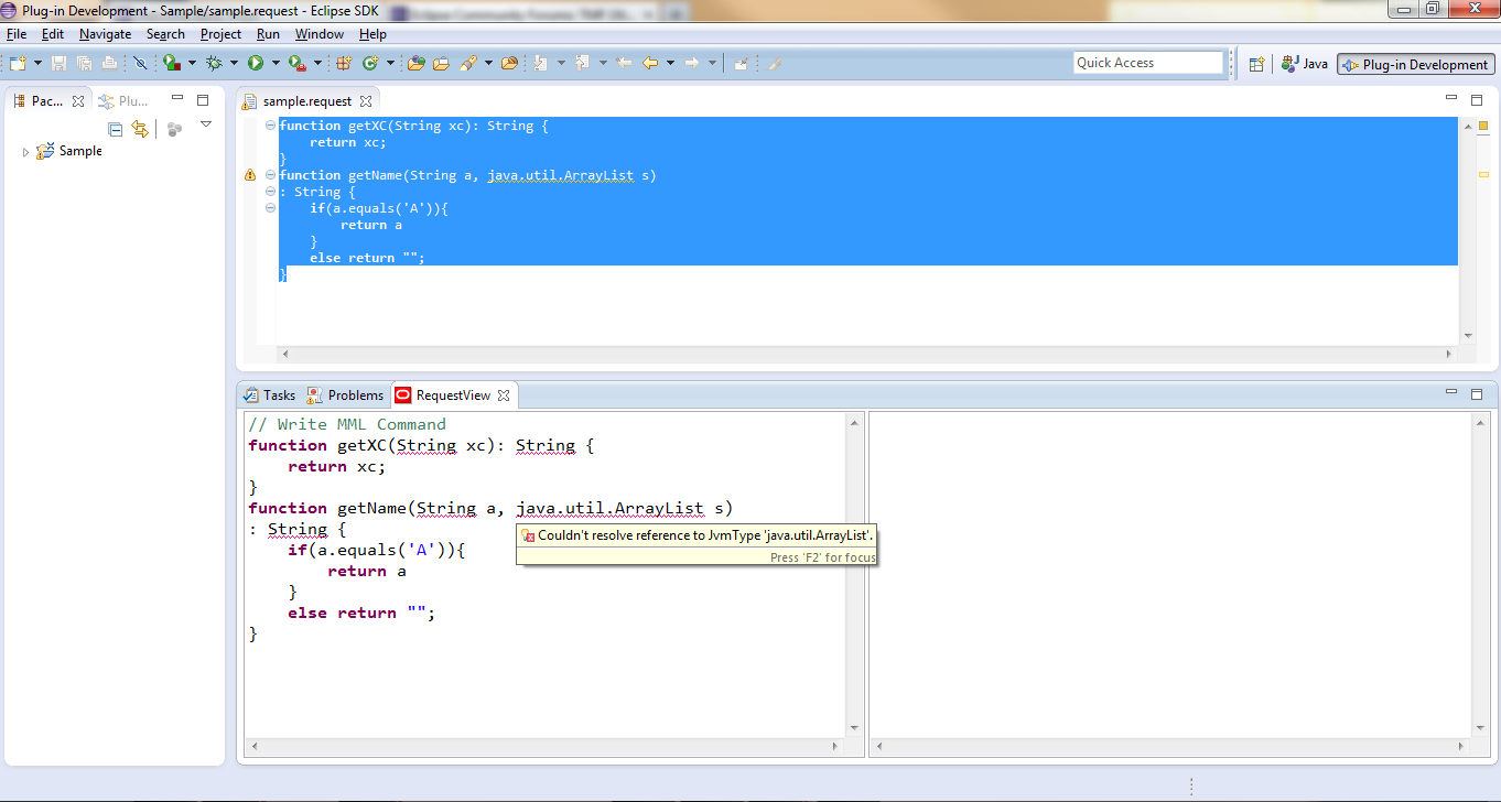

Inside my grammar I am using FullJvmFormalParameter and JvmTypeReference types for my function argument and return types resp. For below method definition(language), the editor is not showing any error
function getXC(String xc): String {
return xc;
function getName(String a, java.util.ArrayList s)
: String {
if(a.equals('A')){
return a
else return "";
But I am getting error markers when I write the function inside my view "Couldn't resolve reference to JvmType 'String'.". Attaching the screen shoot for your reference.
Could you please tell, what am I missing here ?

Re: Xtext-enabled TextArea [message #1086486 is a reply to message #1086483] Wed, 14 August 2013 05:06 Go to previous messageGo to next message
The question is: did you do the changes i do in the uimodule?
if not you need a physical java project you let the resource you edit point to respectively come from
Re: Xtext-enabled TextArea [message #1086487 is a reply to message #1086486] Wed, 14 August 2013 05:09 Go to previous messageGo to next message
For view, whatever is needed I did that. I am not sure what am I missing Sad
Sorry, I did not understand the second sentence!!
Re: Xtext-enabled TextArea [message #1086490 is a reply to message #1086487] Wed, 14 August 2013 05:11 Go to previous messageGo to next message
if the resource you edit physically comes from a java project and the resource you create is tied to this java project it should work out of the box (IResourceSetProvider)
Re: Xtext-enabled TextArea [message #1086496 is a reply to message #1086490] Wed, 14 August 2013 05:18 Go to previous messageGo to next message
For editor I have the resource tied to java project and it is working fine.
But how can I tie a view to java project ? The problem I am facing is in the view
Re: Xtext-enabled TextArea [message #1086498 is a reply to message #1086496] Wed, 14 August 2013 05:20 Go to previous messageGo to next message
using a different version of org.eclipse.xtext.ui.editor.embedded.IEditedResourceProvider
e.g.
public class ModelQueryLanguageEditedResourceProvider implements IEditedResourceProvider {
	@Inject
	IResourceSetProvider rsp;
	private IProject project;
	public IProject getProject() {
		return project;
	public void setProject(IProject project) {
		this.project = project;
	public XtextResource createResource() {
		return (XtextResource) rsp.get(project).createResource(URI.createURI("platform./resource/"+project.getname()+"/test.mql"));
[Updated on: Wed, 14 August 2013 05:20] by Moderator

P.S: are you sure it dosent work with
	@Inject
		return project;
		return (XtextResource) rsp.get(project).createResource(URI.createURI("test.mql"));
simply call setProject on the ModelQueryLanguageEditedResourceProvider
you pass to the embeddedEditorFactory
