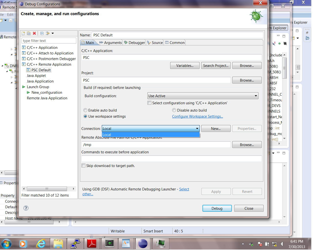

My setup is win7_64, Juno, With the C/C++ application support added.
The problem is with the connection on the Debug Configuration properties page. I hit the 'new' button, enter the info for an ftp debug session, click apply/OK, and the connction I just added does not appear. I then close out the dialog, open a Remote Connection Explorer perspective, and the connection I added is there. I then go back to the Debug COnfiguration and all that appears is 'Local', and none of the other connections. Here is a picture if what I am talking about.
index.php/fa/15779/0/
Any ideas? What am I doing wrong?

[SOLVED] Re: Debug Config, not showing 'new' connections [message #1078070 is a reply to message #1077308] Fri, 02 August 2013 09:52 Go to previous message
Found out what happened, and for edicication of other Eclipse users... It turned out to be the selection made for the type of Remote System selected when I created a connection. I had selected FTP Only which is half right, and does not fulfill the debug's needs. In creating a new selection one must select the OS on the target (In my case, Linux), and go from there. Then the connection shows up on the debug screen.
