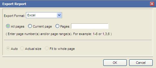

I want to serve my project for Russian, but the report view is English, though the report file is localized by me. But when I click the print and export icon, it show the detail in English. How to resolve this? thanks a lot.
  • Attachment: birt4.jpg
    (Size: 14.75KB, Downloaded 128 times)

You might check out the Babel language packs:
http://www.eclipse.org/babel/downloads.php
