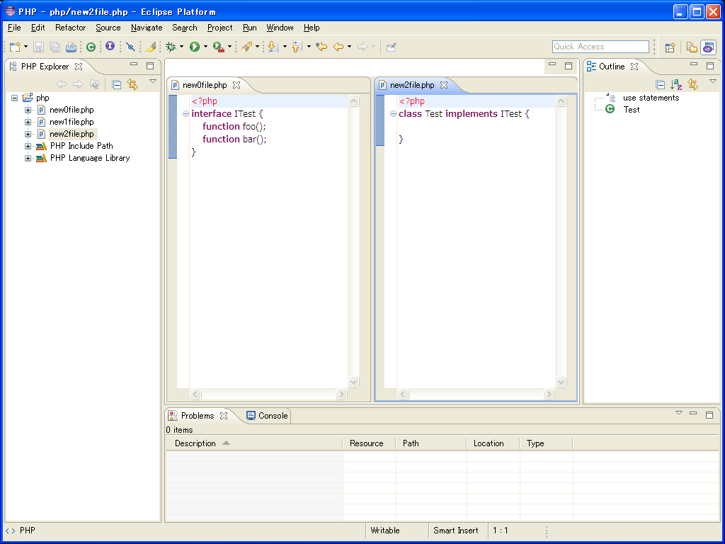

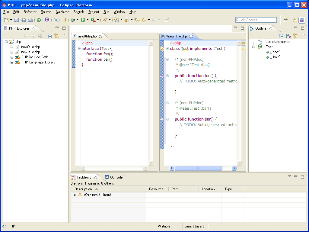

Ah, it seems there is a bug in PDT Extensions.(I'm not using it) It works in a very simple case but not in some cases. (also, the preference page looks like have another problem)
It's better to report the bug against PDT Extensions team.(Not PDT)
Tested:
Eclipse Platform 4.3.0.I20130605-2000
PDT Extensions 0.16.1.201305301841
PHP Development Tools (PDT) 3.2.0.201306051924
working - just after doing quick-fix
index.php/fa/15415/0/
not working - with second file having same class name
index.php/fa/15416/0/

There is also a bug when implementing 2 interfaces with the same method names. It adds both sets therefore causing an ambiguous public interface.
