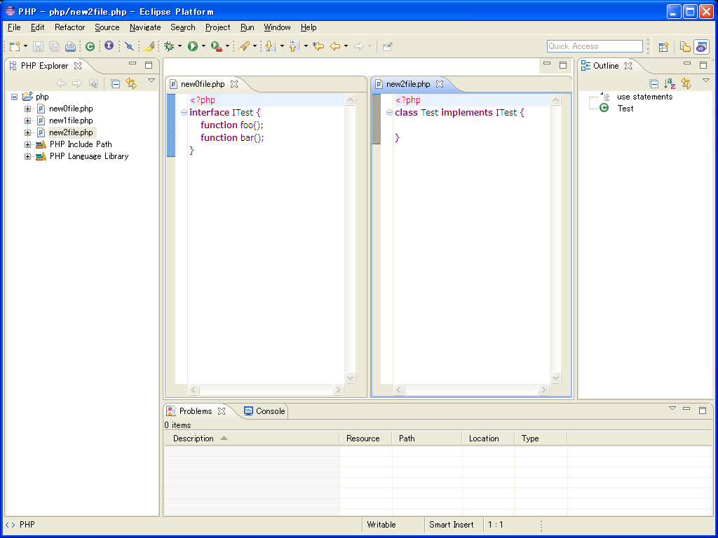

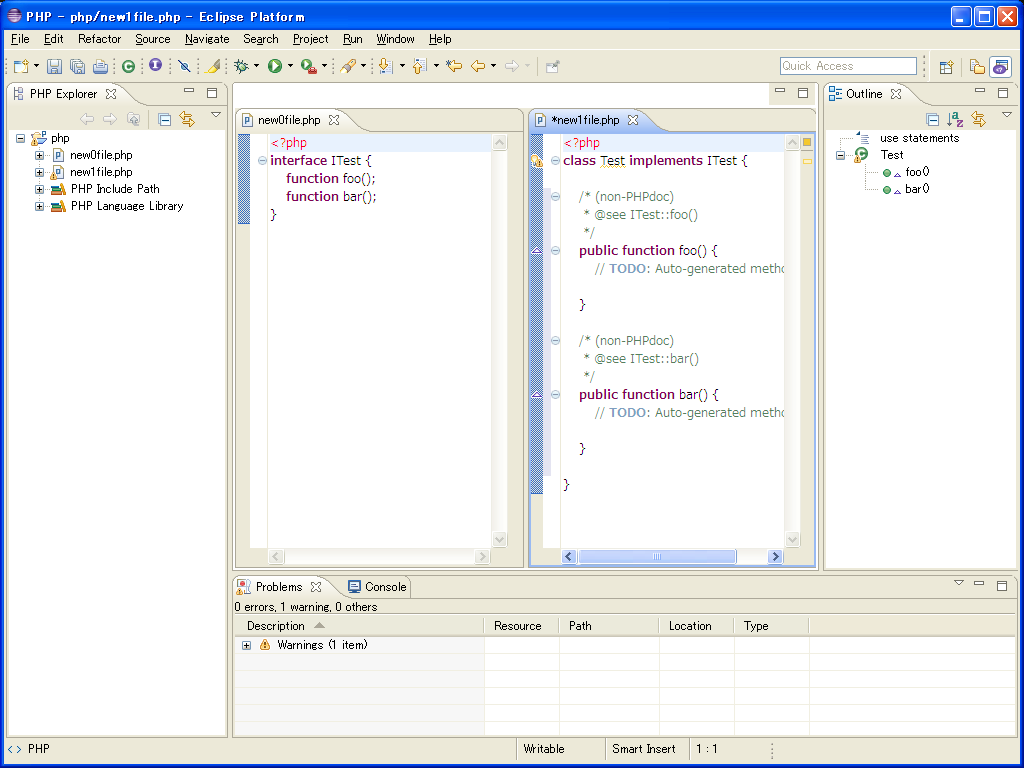

Tested:

working - just after doing quick-fix
index.php/fa/15415/0/
not working - with second file having same class name
index.php/fa/15416/0/
  • Attachment: working.png

  • Attachment: not_working.png
