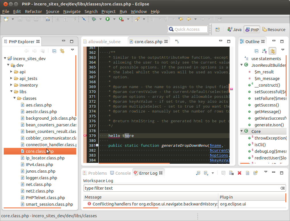

Is there a way to have the filenames indicate that there is an error in the file, from inside the php explorer window on the left as shown in this screenshot.
As you can see in the screenshot, the file core.class.php has a 'hello there' message that causes an error and is highlighted in the file. However, the file core.class.php is just plain white (no error emblem like you would get in Netbeans for example).
Ideally, it would be great if the files indicated that there were errors or warnings etc, that way I dont have to visit every file in the codebase in order to check if there are any problems.

Look icons in your project carefully. It tells your folders are not Source Folders. You must configure your Build Path.(e.g. right-click the project->Build Path->Use as Source Folder)(or open project properties->PHP Build Path->Add Folder)(or such)

Thank you for getting back to me. I have since 'resolved' the issue by installing the zend pdt version of eclipse and linking the source folder worked in there.
