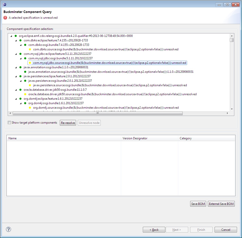

All,
When importing this MSPEC
http://git.eclipse.org/c/cdo/cdo.git/plain/plugins/org.eclipse.emf.cdo.releng/local.mspec
the following error shows up in my Eclipse console:
ERROR [0142] : java.lang.IllegalStateException: basedir
C:\Users\caspar_d\git\cdo\features\org.eclipse.emf.cdo.dawn.ecoretools.diagram.dawn-feature does not exist.
And at the same time the "Component Query" dialog reports a number of unresolved specifications (see attachment).
What does this mean?
It appears the problem is peculiar to my environment. When the CDO project lead attempted the same import, he didn't have any problems.
Help please.
Caspar
  • Attachment: screen1.jpg
    (Size: 210.95KB, Downloaded 307 times)
[Updated on: Mon, 17 June 2013 06:09] by Moderator

Re: Error 0142 [message #1065065 is a reply to message #1064018] Mon, 24 June 2013 04:18 Go to previous message
I don't know whether this is your case, but in the past I experienced
problems with CDO materialization which were due to memory consumption...
I solved these problems by adding to my eclipse.ini these
--launcher.XXMaxPermSize
256M
-vmargs
-Xms512m
-Xmx1024m
-XX:PermSize=256M
hope this helps
Lorenzo
