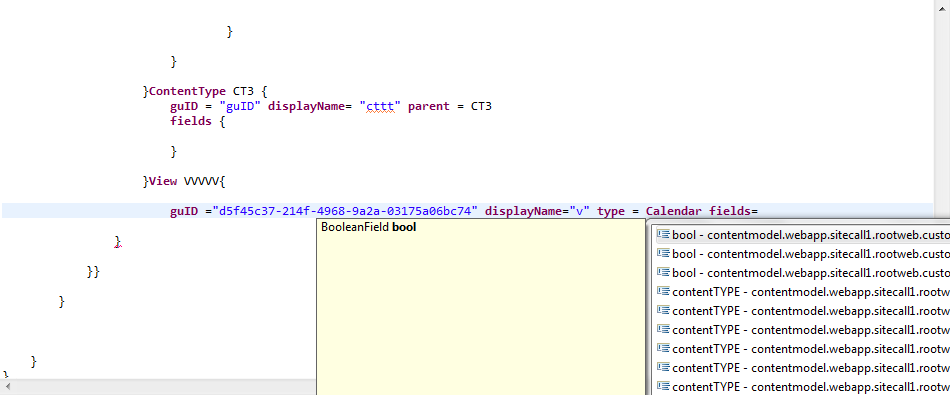

Re: CTRL+SPACE action [message #1063278 is a reply to message #1063274] Wed, 12 June 2013 17:59 Go to previous messageGo to next message
I tried this code .my result is below screenshot. gets all field Sad
Christian Dietrich wrote on Wed, 12 June 2013 17:51
here is my current version
class MyDslProposalProvider extends AbstractMyDslProposalProvider {
	override completeViewField_Field(EObject model, Assignment assignment, ContentAssistContext context, ICompletionProposalAcceptor acceptor) {
		val view = EcoreUtil2::getContainerOfType(model, typeof(View))
		val names = view.ownedViewField.map[vw|vw.field?.name].filter[v|v!=null].toList
		println (names)
		lookupCrossReference(assignment.terminal as CrossReference, context, acceptor, [
			IEObjectDescription d | println(d.qualifiedName);!names.contains(d.qualifiedName.toString)
  • Attachment: screennn1.png
    (Size: 25.22KB, Downloaded 261 times)

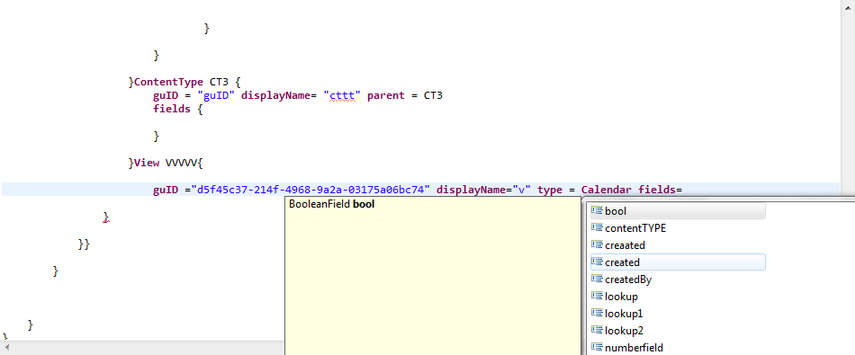

Re: CTRL+SPACE action [message #1063280 is a reply to message #1063278] Wed, 12 June 2013 18:03 Go to previous messageGo to next message
Sorry once more you are mixing up 1000 things
this code filters duplicates.i dont see duplicates ?!?
it does not take care about the scope of all possibilites.
(this was a different thread !?!)
Re: CTRL+SPACE action [message #1063283 is a reply to message #1063280] Wed, 12 June 2013 18:14 Go to previous messageGo to next message
Hi ,
oke ,it do now .sorry ,did not realize Sad I understand noww thanks for replly.
Now I will do second constraints.I remove same type .I can do it in AbstractMyDslProposalProvider?

Re: CTRL+SPACE action [message #1063294 is a reply to message #1063278] Wed, 12 June 2013 18:36 Go to previous messageGo to next message
I used this code and duplicate names are remove.
but I use for field qualifiedname : overridequalifiedname screenshot
@Inject
			IQualifiedNameConverter qnc;
			QualifiedName qualifiedName(Field f) {
				System.out.println("******"+f.getName());
				return qnc.toQualifiedName(f.getName());
if I do not use QualifiedName qualifiedName(Field f),result screenshot:withoutqualifiednameoverride:gets all field.
must I use IQualifiedNameConverter qnc?

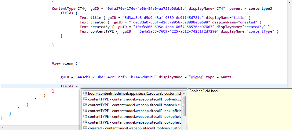

Re: CTRL+SPACE action [message #1063538 is a reply to message #1063408] Thu, 13 June 2013 07:50 Go to previous messageGo to next message
Hi Christian,
now,My problem is qualifiedname.
I used qualifiedname :
public class QNP extends DefaultDeclarativeQualifiedNameProvider{
System.out.println("++++++++++++++++++++++++"+f.getName());
return qualifiedName(f.getName());
Result:

Re: CTRL+SPACE action [message #1063704 is a reply to message #1063702] Thu, 13 June 2013 15:37 Go to previous messageGo to next message
Hi Christian
I solved http://www.eclipse.org/forums/index.php/t/488676/-> this topic's problem.Hence My grammar hierarch and scop same in this project (zip)http://www.eclipse.org/forums/index.php/t/488676/->
My onlly problem qualifiedname and below post(this thread).
My aim is :I dont get duplicate name and same type field in the View's ViewField.(fields).and I want to gets field with qualifiedname.
Hence,I do not use my util class,I share it above.I hope I explain my problem Sad
if I use qualifiedname ,My result is below screenshot.I can't use x.y.z now

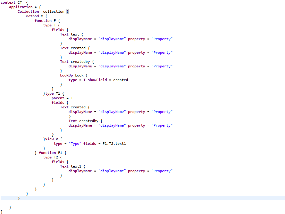

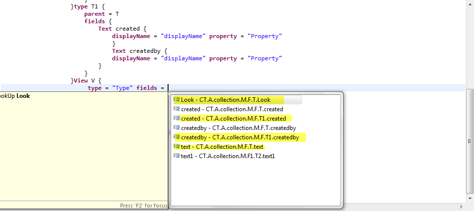

Re: CTRL+SPACE action [message #1063724 is a reply to message #1063710] Thu, 13 June 2013 17:09 Go to previous messageGo to next message
Hi Christian ,
I load my grammar ,I added View and ownedfield.
I load sample model screenshot.
My aim is : remove fields that has same name and same type ( such as text and lookup) for View's ownedfield
******gets onnly function's fields (function is upper from the View).hence Screenshot :
View V 's fields get onnly function F's defined fields (text ,lookup):
I load "myexample" screenshot .I marked yellow wanted field (get these fields)
Hence "type" has a "parent" tahat is a type.this type's fields must get.
I hope ,I explain my problem Sad

Hi Christian,
ok,sorry.We can talk one problem.
I want to usequalifidname everywhere.My util class ,I post it.My aim is use it hence I want to start qualifiedname from Method .MQNP class is not work :(Sad I want to use it for qualifiedname.I do not want to start with Context.
such as :
parent = CT.A.collection.M.F.T1 :I do not want
I am wanted :M.F.T1
such as :
View V {
type = "Type" fields =M.F.T.text
context CT  {
	Application A {
		Collection  collection {
			method M {
				function F {
					type T { parent = CT.A.collection.M.F.T1
						fields {
							Text text {
								displayName = "displayName" property = "Property"
							Text created {
							Text createdby {
							LookUp Look {
								type = T showField = created
					}type T1 {
						fields {
							Text created {
								Text createdby {
							Text created {
								displayName=" ewfg" property= "Property"
					}View V {
						 type = "Type" fields =CT.A.collection.M.F.T.text
				} function F1 {
					type T2 {  parent =CT.A.collection.M.F.T
						fields {
							Text created {
						   Text created {
						Text look2{
							displayName = "displayName" property = "Property"}
							Text text2{
					}type  T3 {
						fields {
							Text t3333 {
								Text t3333 {
								Text text2 {
					View Viweww {
						type = "Type"  fields =CT.A.collection.M.F1.T3.t3333

I start my qualifiedname with Method .but My Method rule is recursive.hence if I define one Method ,below code (return qnc.toQualifiedName(f.getName())) return second Method name.How can I solved this.
I want to fields =M. M1.F.T1.created for every referenced name.
such as :
method M {
				method M1{
				function F {
					type T {
						fields {
							Text text {
							Text created {
							Text createdby {
							LookUp Look {
					}type T1 {
						fields {
							Text created {
								Text createdby {
							Text created {
					}View V {
						 type = "Type" fields = M1.F.T1.created

Hi Ed,
I think ,I can not use my util class.
I write a code now but recursive Method part .I cant do this part.I don t traverse in the Method
Below code result is :
View Viweww {
type = "Type" fields =M.F1.T2.created }
I dont get M1 Sad

and I try this (below) code result :View Viweww {
type = "Type" fields = M.M1.F1.T2.created}
I am wanted is this,but I receive an error :(Sad couldun't resolve reference .What is the my error Sad
