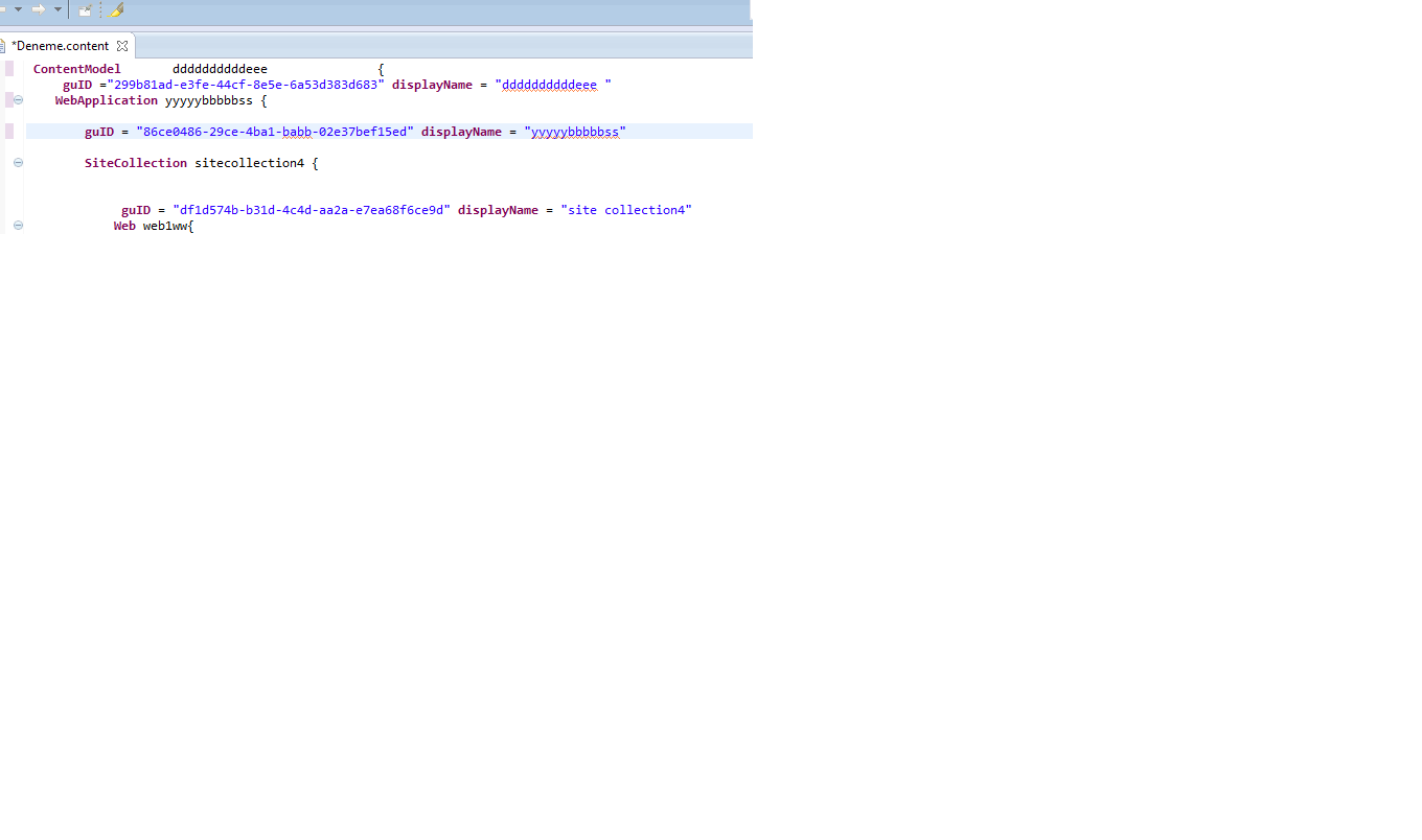

Hi Christian ,
After I have written this code,Auto Completion is not active.When I enter ctrl+space,does not come any auto completion (not open diaglog page):my first problem is this.
Second problem is :I load screenshot.I wrote "displayName = "ddddddddddeee "": There is a blank end of the displayname.and then, When I save the editor :
ContentModel ddddddddddeee { :here ,"{" curly bracket shifting one space.
if I write "displayName = " ddddddddddeee"" :a blank begin ,Name "ddddddddddeee" shifting.
İf I wite "ddddddddddeee" :there isnt any blank , Nothing happens :not change name with displayname.

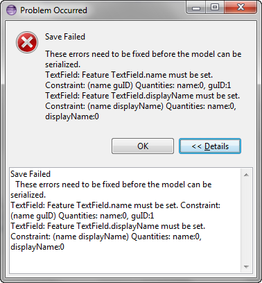

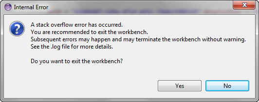

BUTTT :I take an error ->
Save Failed
java.lang.StackOverflowError
Wehere do I error ?please heelp me I do not understand .is it a bug?

My grammar is below.When I create a contenttype ,ContentType's Fields are created automatically:ownedField+=Field (ownedField+=Field)*)?
When I create ContentType below Text Field is created automatically in the Xtext Editor.User may change its property onlly.I hope ,I can explain my problem.
Text text {
guID = "guID"
displayName="bollty u" required = true unlimitedLenghtInDocumentLibraries= false default = "Default"
[Updated on: Tue, 28 May 2013 04:45] by Moderator

I solved internal name and Displayname.When I save editor,qualifiedname is wrote in the displayname field and if qualifiedname has emtpt ,remove blanked and then rewrite fullname, and first blanked name is written in the displayname field.I solved my problem .All changes manupulation on the editor .I written my code in the
public void afterSave(XtextEditor editor) .
Now ,I want to drived process (create default field in the right place on the editor when one element is created).I may use XtextDocumentProvider.doSaveDocument.Hence when Xtextdocument is saved ,I will create default elements.Do you have offered an example?

I receive an error :
Save Failed
These errors need to be fixed before the model can be serialized.
TextField: Feature TextField.displayName must be set. Constraint: (name displayName) Quantities: displayName:0, name:0
TextField: Feature TextField.name must be set. Constraint: (name guID) Quantities: guID:1, name:0
Re: Xtext Save Action [message #1060935 is a reply to message #1060932] Wed, 29 May 2013 04:37 Go to previous messageGo to next message
the error message should be clear !?!
Re: Xtext Save Action [message #1060963 is a reply to message #1060935] Wed, 29 May 2013 06:37 Go to previous messageGo to next message
Hi Christian,
Error is in the dialog window.load screenshot.
  • Attachment: saveerror.png
    (Size: 29.11KB, Downloaded 136 times)
Re: Xtext Save Action [message #1060973 is a reply to message #1060963] Wed, 29 May 2013 07:41 Go to previous messageGo to next message
Hi Christian,
My problem is solved with setDocumentContent method.I confused Sad

Re: Xtext Save Action [message #1061193 is a reply to message #1061030] Thu, 30 May 2013 09:24 Go to previous messageGo to next message
Hi Christian ,
I try this method for my problem.but do not works .really I do not understand my error.I debug it ,if condition is error.but I do not find Sad
private final class addAutomaticField implements IAutoEditStrategy {
		@Inject
		Provider<IGrammarAccess> iGrammar;
		private String contents;
		private Set<String> kwds;
		@Inject DocumentUtil u;
		public void customizeDocumentCommand(IDocument document,
				DocumentCommand command) {
			List<String> keywords = Arrays.asList("ContentType"
			StringBuilder sb = new StringBuilder();
			for (String s : keywords) {
				sb.append(s);
				sb.append("|");
			String keywordsString = sb.deleteCharAt(sb.length() - 1).toString();
			String pattern = String.format("\\b(%s)\\b((\\w|\\s|\\.)+)[{]",
					keywordsString);
			Pattern compile = Pattern.compile(pattern);
			String alldocument = document.get();
			//System.out.println(alldocument);
			java.util.regex.Matcher matcher = compile.matcher(alldocument);
			final List<String> contentUnitNames = new ArrayList<String>();
			while (matcher.find()) {
	          String kelime = matcher.group(2).trim();
				 contentUnitNames.add(kelime);
				 System.out.println(contentUnitNames);
			try {
				int i=0;
				while(i<=contentUnitNames.size()-1){
					String s=	contentUnitNames.get(i).toString();
					System.out.println(s);
					int index =contentUnitNames.get(i).length();
					System.out.println(index);
					int offsetindex=12+index;
if (command.text.equals("{") && document.get(command.offset-offsetindex,offsetindex).equals("ContentType "+s)) {
//if (command.text.equals("{") && document.get(command.offset-16,16).equals("ContentType cccc")) {
					//System.out.println(contentUnitNames.get(0).length());
					contents = document.get();
					String afterCommandString = contents.substring(command.offset, document.getLength());
					contents = document.get(0, command.offset);
					contents = contents + " guID = "+ GUIDGenerator.generateUniqueId() +  "Text text {";
					contents = contents + afterCommandString;
					document.set(contents);
					contents = null;
				} else {
					if (contents != null) {
						contents = null;
			i++;
				}//forun
			}catch (BadLocationException e) {
				e.printStackTrace();
Best Regards
