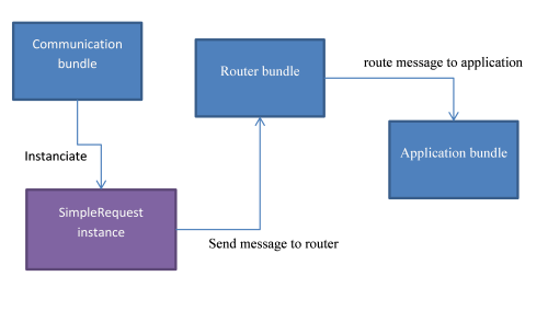

Hi all i have a problem with the bundle redeploy procedure :
Here the code in Application bundle :
if (message instanceof SimpleRequest)
	SimpleRequest request = (SimpleRequest) message;
	return new SimpleResponse(request.getMessage() + " MODIFIED !");
When i send the message to the application through the router, the message is catch by the appliaction and all works.
If i make a redeploy of communication bundle only (via pickup or eclipse virgo tool), i have an error in application bundle.
The message is not identified as SimpleRequest. If i cheat the IF case, i have an exception like : SimpleRequest cannot be cast to SimpleRequest.
SmpleRequest is declared only in communication bundle.
That's look like the class loader have two declaration of the SmpleRequest class.
I have look in deployer folder of virgo, i have find two SimpleRequest.class, one in work\deployer\s\global\23\0 and another in work\deployer\s\global\23\1.
I have join a message workflow image.
Thx for your help.

Re: Redeploy / ClassLoader problem [message #1058249 is a reply to message #1053123] Mon, 13 May 2013 06:56 Go to previous message
It seems that this scenario does not drive refresh packages to update the application bundle appropriately. You probably need to debug into the Virgo code to determine what's going on.
