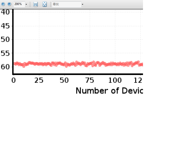

I have some dynamic JFreeChart charts which need to be inserted into pdf report
I used iText before. the code like the following:
private Image genJfreechartImage(PdfTemplate tp, JFreeChart chart, float width, float height)throws BadElementException, DocumentException{
Graphics2D g2d = tp.createGraphics(width / 40, height / 40, true, 0);
Rectangle2D r2d = new Rectangle2D.Double(0, 0, width, height);
AffineTransform affineTransform2 = AffineTransform.getTranslateInstance(0, 0);
affineTransform2.scale(0.025, 0.025);
g2d.transform(affineTransform2);
g2d.transform(AffineTransform.getTranslateInstance(0, 0));
chart.draw(g2d, r2d, null);
com.itextpdf.text.image img = Image.getInstance(tp);
g2d.dispose();
g2d = null;
float pageWidth = (float) (PageSize.A4.getWidth() * 0.9);
float percentage = (pageWidth / img.getWidth()) * 100;
img.scalePercent(percentage, percentage);
return img;
in this method, I got the vector image in pdf which will not be distorted after zoom in, the pdf file size is small and the generating report time is quick

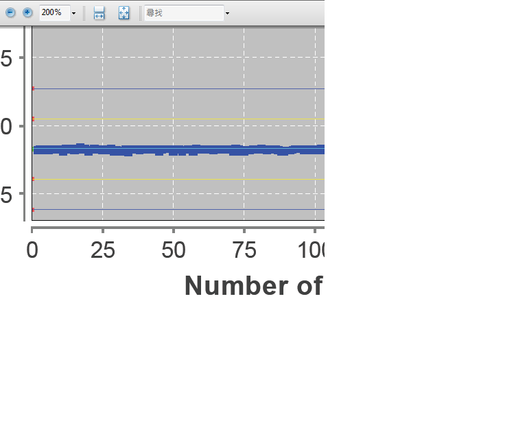

Now I use birt-4.2, I use dynamic image which takes byte array as source, so my code is:
public byte[] getByteArray(List<ChartData> chartDataList, int width, int height, boolean isDualAxis) {
byte[] png=null;

in this method, the image in pdf is distorted after zoom in, the file size is bigger and the generating time is long

the attached files are 2 pictures from itext report and my new birt report, the itext picture is not distorted after zoom in
  • Attachment: itext.png
    (Size: 19.57KB, Downloaded 311 times)
  • Attachment: birt.png
    (Size: 47.66KB, Downloaded 342 times)
