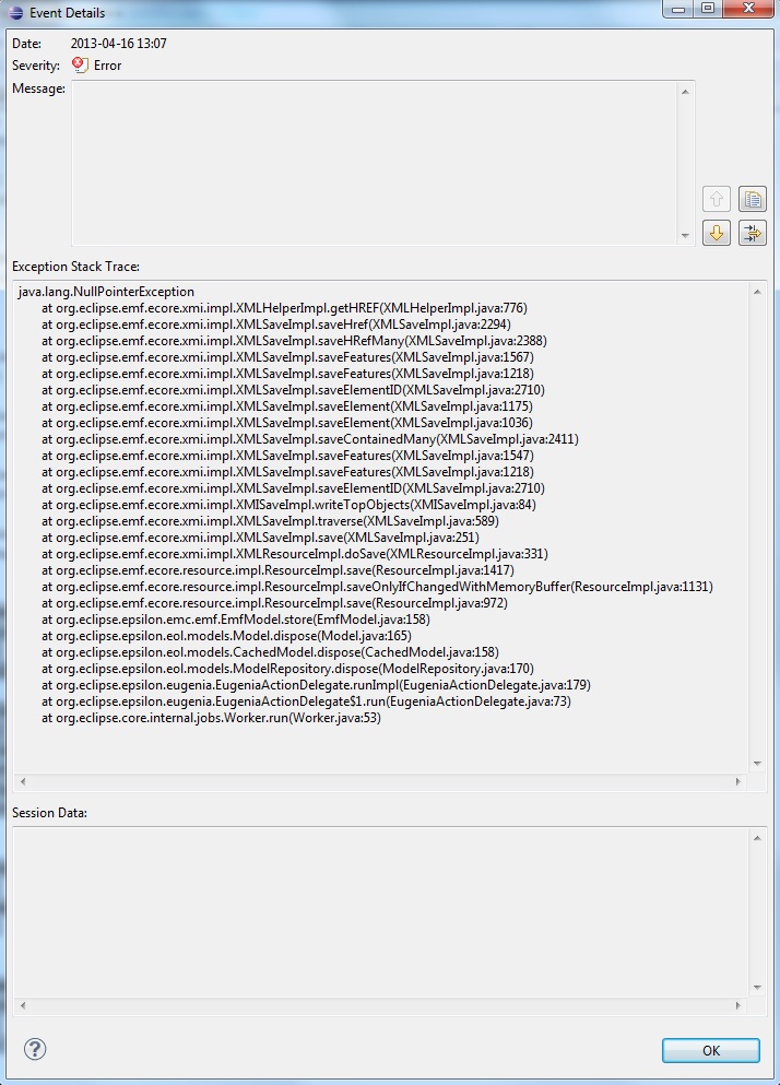

I seem to have stumbled upon an error[1] that I find strange and I was wondering if anyone could help me with it. I get it when I try to run "Eugenia->Generate GMF tool, graph and map models" on my ecore file after I have annoted it in an emf file.
The error seems to be related to PossibleValues section in my XText grammar below:

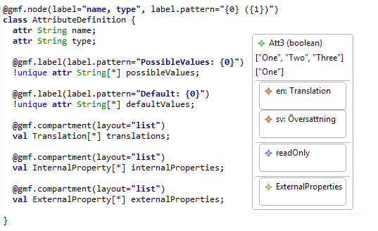

The closest to valid Eugenia annotations would be the following:
@gmf.node(label="name, type", label.pattern="{0} ({1})")
class Node{
attr String name;
attr String type;
@gmf.label(label.pattern="PossibleValues: {0}")
!unique attr String[*] possibleValues;
@gmf.label(label.pattern="DefaultValues: {0}")
!unique attr String[*] defaultValues;
Would this be close to what you're after?
Cheers,
Dimitris
  • Attachment: node.png
    (Size: 6.16KB, Downloaded 237 times)
Re: Emtpy Error when generating GMF tool, graph and map models [message #1043839 is a reply to message #1043358] Thu, 18 April 2013 03:19 Go to previous messageGo to next message
Hi Dimitris
Yes, that could look quite nice. Sadly when I type it like you do I still don't get the texts "PossibleValues" and "DefaultValues" for some reason[1].
Am I missing some update or something? I have downloaded the Eclipse Distribution from the epsilon homepage and I have Eugenia version 1.0.0.201211082326.
Or a longshot but I doubt it, it doesn't have anything to do with EGit? Get a warning because I don't have Git installed and the variable HOME declared when I start eclipse... but I doubt thats the problem just tossing things out there to try and cover more ground in one post Smile
Thanks for your time and patience
Write you later / Mårten

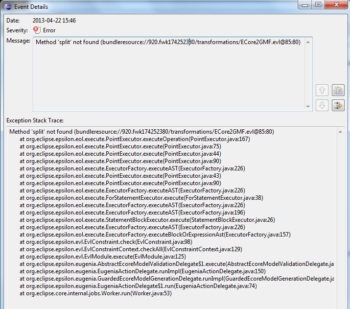

Think I found an error in your new code related to the labels.
Because of a structural change in my XText grammar I had to change what I used in my label to a reference so I couldn't use it in my label anymore. (No such object objection)
So I tried to remove the label with @gmf.label(label.placement="none") but then I get a split error I didn't get with the older code.
Haven't used so much bug-report systems but should I try to add it in the link you posted before Dimitris?
[EDIT: Added the picture of the error message]
[Updated on: Tue, 23 April 2013 02:58] by Moderator
Re: Emtpy Error when generating GMF tool, graph and map models [message #1048540 is a reply to message #1047406] Wed, 24 April 2013 12:06 Go to previous messageGo to next message
Hi Mårten,
Thanks for reporting this. Could you please file a new bug and attach a copy of your metamodel that we can use to reproduce this?
https://bugs.eclipse.org/bugs/enter_bug.cgi?product=EMFT.Epsilon
Cheers,
Dimitris
Re: Emtpy Error when generating GMF tool, graph and map models [message #1048957 is a reply to message #1048540] Thu, 25 April 2013 02:55 Go to previous message
Hi Dimitris,
I have submitted a bug report here so have fun Smile
