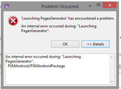

The generator worked when launched as "acceleo application", without the lines of code above. When I add the lines, running as java application I get the error above. But when I try to run as "acceleo application" again, I get following error:
index.php/fa/14346/0/
So that does not work anymore.
What should I do?
extra info: I added the ecore model (project with model & genmodel etc) as a project reference in the build path properties of my acceleo generation project.
  • Attachment: error.PNG
