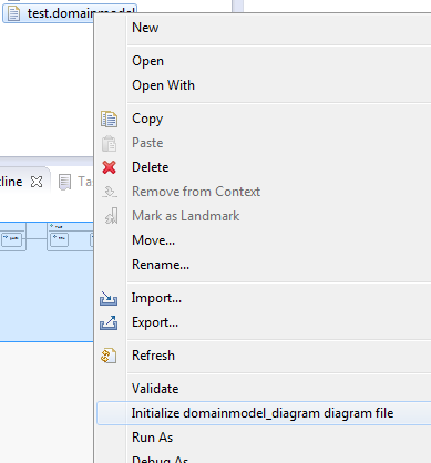

Re: Xtext Graphical View [message #1041951 is a reply to message #1041684] Mon, 15 April 2013 16:18 Go to previous messageGo to next message
Ok I've been having all the possible problems to reproduce this example. I just follow all the steps that Dimitris wrote but for some reason, even when diagram package is creating correctly, when I launch the new Eclipse Application I don't see the option for initialize the diagram file.
I've been looking for all the possible explanation but nothing until now.
[Updated on: Tue, 16 April 2013 08:11] by Moderator
Re: Xtext Graphical View [message #1041972 is a reply to message #1041951] Mon, 15 April 2013 16:52 Go to previous messageGo to next message
Hi Daniel,
The file extension for the "Initialize XYZ Diagram" menu item is specified through an extension to the "org.eclipse.ui.popupMenus" extension point in plugin.xml of your .diagram project. To change it, you need to change the value of its nameFilter attribute.
Cheers,
Dimitris
Re: Xtext Graphical View [message #1042421 is a reply to message #1041972] Tue, 16 April 2013 08:11 Go to previous messageGo to next message
Once again thanks a lot Dimitris, that was the solution for my problem. Now finally I can begin with my homework.

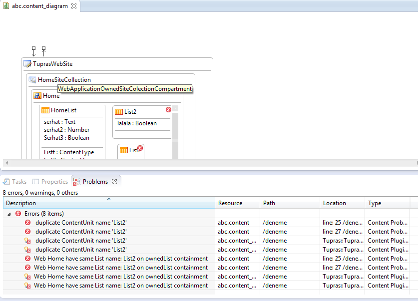

Re: Xtext Graphical View [message #1053736 is a reply to message #1053155] Tue, 07 May 2013 08:35 Go to previous messageGo to next message
problem fixed, when i get update and recreate project. But now i have another problem
too I make new project (with synchronization steps) and then i write epsilon evl for
model validation it works perfect. But gmf error occured on diagram and xtext file
(separately) and evl quick fixed dont run on xtext file. Because of this i want error
and warnings dont occure on xtext file. How can i done this ? Anyone can help me ?
Just i want to write aperate error and warning for xtext file and gmf diagram
(sample scenario on attached picture.)

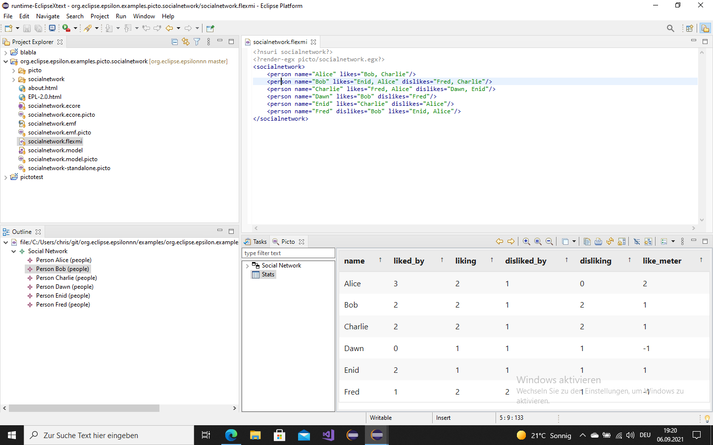

Re: Xtext Graphical View [message #1844162 is a reply to message #1036564] Fri, 03 September 2021 13:46 Go to previous messageGo to next message
Hello! I know, Eugenia is outdated but I've already written myself into it(bc a kolleagues' similar project used it) and I simply need a graphical view of my xtext model which has to be able to change live slightly (coloring the nodes to show status and showing a counter would be enough). I simply want to finish that project as quickly as possible, no need for anything fancy. I tried that steps from the beginning of the thread and I have two issues here: first when generating edit code, numerous classes would be needed in the .provider package which arent existing( classes that would be generated with an GMF editor I think), and second when creating a generator model a "All references are unique in EMF due to the current code generation" error appears which I cant deal with. In case you dont see a chance to go on with Eugenia, which software would you recommend considering my explained tasks? Thank you in advance!
Re: Xtext Graphical View [message #1844164 is a reply to message #1844162] Fri, 03 September 2021 14:47 Go to previous messageGo to next message
Hi Christoph,
Does this help? https://www.eclipse.org/epsilon/doc/articles/picto-xtext/
Best,
Dimitris
Re: Xtext Graphical View [message #1844172 is a reply to message #1036564] Sat, 04 September 2021 07:03 Go to previous messageGo to next message
Thank you, that looks quite good and that I can use it in the same runtime as the xtext editor is great. But before I start I need to be sure of some things:
The graphical view is needed to monitor the flow of a recipe (with parallel steps, I guess thats possible to view?), so I would therefore need to
1) update the view every other second ( I guess by triggering"getRenderingMetadata" more often so not only when the editor is saved or opened) and
2) beeing able to get color and an Integer from the xtext generator (NOT from the xtext editor but code behind) I guess it would be sufficient if the .egl file could call for it from the generator).
Do you think that tasks are somehow doable? Or do I need to look for some other software? Thanks for the help!

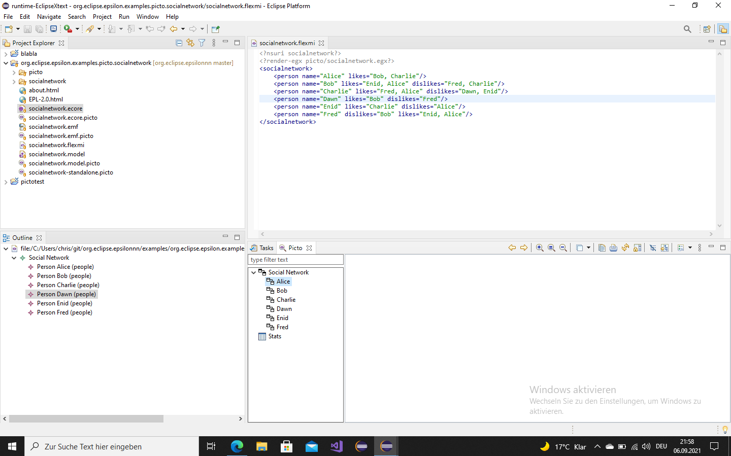

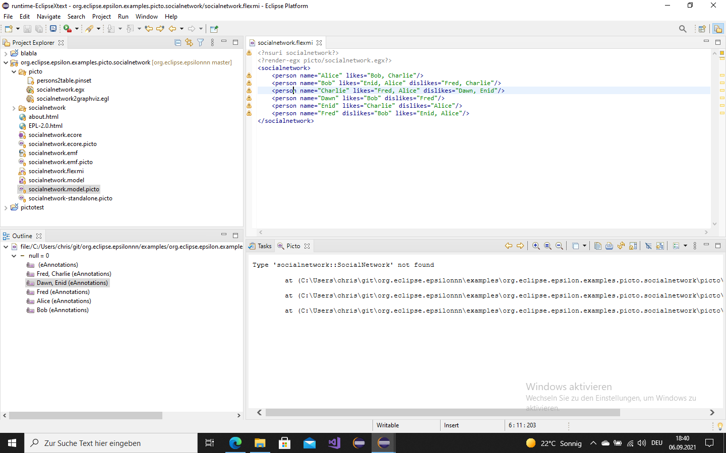

Re: Xtext Graphical View [message #1844225 is a reply to message #1844220] Mon, 06 September 2021 12:43 Go to previous messageGo to next message
Hi Dimitris,
unfortunately not, maybe you have a look at this screenshot.
I also tried the xtext-picto example with another laptop, same result...
nonetheless will I now start with my own picto integration - Is there a handy way to create the .picto project to get all necessary plugin dependencies and other stuff like in the example project?
Thank you very much for the help!
Chris

Re: Xtext Graphical View [message #1844227 is a reply to message #1844225] Mon, 06 September 2021 13:05 Go to previous messageGo to next message
Please try closing the editor, registering socialnetwork.ecore and opening the editor again.
Best,
Dimitris
Re: Xtext Graphical View [message #1844228 is a reply to message #1844227] Mon, 06 September 2021 13:21 Go to previous messageGo to next message
That helped somewhat, it now looks like this
Re: Xtext Graphical View [message #1844229 is a reply to message #1844228] Mon, 06 September 2021 14:00 Go to previous messageGo to next message
What about the rest of the views in the tree? Do they render ok?
Re: Xtext Graphical View [message #1844231 is a reply to message #1844229] Mon, 06 September 2021 16:00 Go to previous messageGo to next message
oh I overlooked them^^ No unfortunately same like with xtext-picto project.
Could a software be missing?

Re: Xtext Graphical View [message #1844303 is a reply to message #1844176] Wed, 08 September 2021 10:03 Go to previous messageGo to next message
Hello Dimitris,
thank you very much reinstalling Graphviz did it for me, my project already looking quite good!
