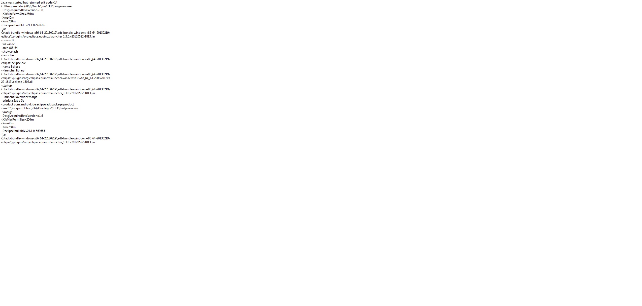

Hi all,
I was tried to run the eclipse from my win 7 64 bit system. I have installed from "adt-bundle-windows-x86_64-20130219". However, when run eclipse.exe, the screen has prompt for error message of java was started but returned exit code=14.
I am attached the error output.
Anyone please help me.
  • Attachment: 1.jpg
    (Size: 157.48KB, Downloaded 1015 times)

On 3/28/2013 9:50 AM, SM Lim wrote:
> Hi all,
So, let me get this straight:
You're running a 64-bit Eclipse on a 64 bit-capable OS, but using a
32-bit JRE?
