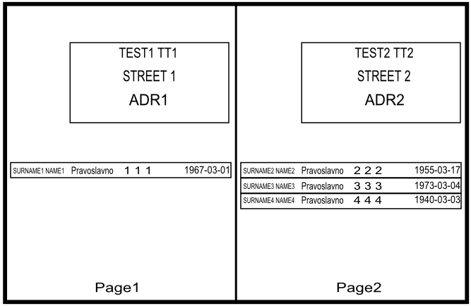

First off all, sorry for my bad English.Im a beginner and i have a problem with designing report from XML data. I wanna make mail ( letter? ) report with pagebreak and not have an idea how to ask for help, better to draw it what i want to make. Embarrassed
Here is the xml and the draw.

Finally i found the answer and works great. Thanks
w w w.birt-exchange.org/org/forum/index.php/topic/21645-nested-xml-data/
