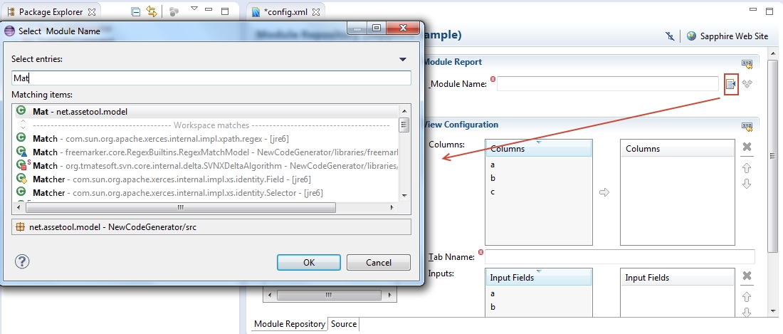

I have implemented a Java Type picker and i have to retrieve the fields available in that particular selected Java Class and pull that out onto the XML as attributes. Screenshot attached !
index.php/fa/13918/0/

Now i want to run Reflection Utils like getDeclaredFields() on the Java Class selected from this window. To get this done i am making use of a service which extends PossibleValuesService .
This custom service class has the Java Reflection code and in this segment i need the class which i have picked earlier to pass a reference to this.
