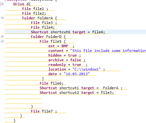

My question is scoping,I write custom validation for drive name (drive name starting with upper case and one character ).I written a validation with above grammar ,but my warning shows all line I want to my warning shows only Drive name.I do not solving this problem :
My validation code :
@Check
public void CheckDriveName(Drive d){
if(d.getName().length()!=1){
error(" 'Drive' name must be one character " ,null,FilesystemPackage.DRIVE__NAME,
NVALID_DRIVENAME, d.getName());
}else if (Character.isLowerCase(d.getName().charAt(0)) ){
warning(" Drive name should start with uppercase " ,null,FilesystemPackage.DRIVE__NAME,INVALID_DRIVENAME,d.getName());
I upload my language screenshot

Re: Check Type of Element [message #1021372 is a reply to message #1021353] Tue, 19 March 2013 20:06 Go to previous messageGo to next message
Hi Christian,
I use this format for error but marked error line
Filesystem filesystem1 {
Drive De{
File file1 ;
File file2;
error("message", d, FilesystemPackage.Literals.DRIVE__CONTENTS, INVALID_DRIVENAME);
DRIVE_NAME is not EstructureFeature so I used FilesystemPackage.DRIVE_NAME previously code Sad
Best Regards

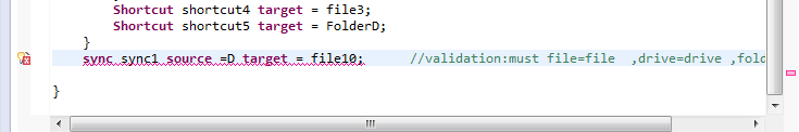

I write validation for Sync .if source is a file type Target must be file.I cehck this case but I want to write quick fix if source is a file, for targer comes files types or just the opposite.I hope understand my problem.I solved this problem How solved Sad
@Check
public void Checkscyn(Sync s){
SyncElement synsource = s.getSource();
SyncElement syntarget = s.getTarget();
if(synsource.eClass() != syntarget.eClass()){
error(" synchronization is incorrect ,use same type element",null, FilesystemPackage.SYNC__NAME,
INVALID_SYCN,s.getName());
Ouick fix:

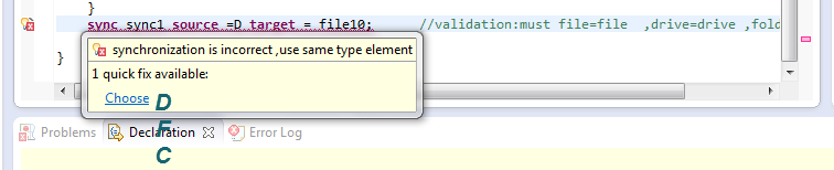

Hi Christian,
I load screenshot.This validation screenshot below:
@Check

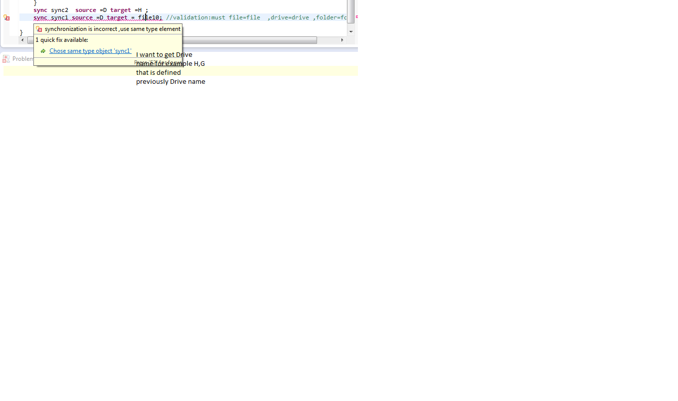

I want to write quick fix if source is a drive (D) target is a Drive type for example :
D,H comes at the Quick Fix screen (I load a screenshot for this case)
I hope ,I can tell my problem Sad How comes related cross reference type for target with quick fix

Hi Christian,
sory I can't understand . I want to bring Drive Name at the quick fix for example Very Happy,C
.User select these one.I put Drive name in a list but ı can t call this function.
I try this code but I do not bring related type.

Re: Check Type of Element [message #1021730 is a reply to message #1021714] Wed, 20 March 2013 11:36 Go to previous messageGo to next message
Hi Christian ,
I can open a dialog page I load a screenshot ,but I can not get possible object.for example :I want to get sorce is a drive name, target must be drive name
so I must get all drive name at the dialog page.OR source is a file ,target must be a file name hence must bring all file name.Sad I try add a fix but wanted objects can not bring.

	@Check
	error(" synchronization is incorrect ,use same type element",s, MyDslPackage.Literals.SYNC__NAME,"code",s.getName());
Re: Check Type of Element [message #1021845 is a reply to message #1021843] Wed, 20 March 2013 15:35 Go to previous messageGo to next message
Btw you may have a look at org.eclipse.xtext.ui.editor.quickfix.DefaultQuickfixProvider.createLinkingIssueResolutions(Issue, IssueResolutionAcceptor) too
(to get some ideas)
Re: Check Type of Element [message #1021861 is a reply to message #1021845] Wed, 20 March 2013 16:20 Go to previous messageGo to next message
Thank you very much for your interest.I'm sorry because I'm new to these issues and having trouble understanding.I try these code but fx.getName() not get in the quick fix dialog page.I want to choose fx.getName for target.in addition I try createLinkingIssueResolutions(Issue, IssueResolutionAcceptor) but parameters wrong ,I am not define correct parameters for createLinkingIssueResolutions.
@Fix( FilesystemJavaValidator.INVALID_SYCN)
public void createsycn(final Issue issue,IssueResolutionAcceptor acceptor){
final String linkText = issue.getData()[0];
acceptor.accept(issue, "choose same type '" + linkText+ "'", "null '" + linkText+ "'", null,
new ISemanticModification() {
public void apply(EObject element, IModificationContext context)
Sync d = (Sync)element;
Filesystem fs = EcoreUtil2.getContainerOfType(d, Filesystem.class);
for (File fx : EcoreUtil2.getAllContentsOfType(fs, File.class)) {
System.out.println(fx.getName());
Re: Check Type of Element [message #1021876 is a reply to message #1021861] Wed, 20 March 2013 16:58 Go to previous messageGo to next message
you have no linking issue so you cannot use it. and it wont solve your problem since the cross ref is valid by semantics of scoping/linking
i just told you to get an idea how a similar not the same problem is solved.
the link text problem i cannot reproduce
the quickfix has the text. Create entity 'xxxx'
sooooooo i have still no clue at all what your problem is. i do not want to do your work.
and a am distrubed by your context switches.
