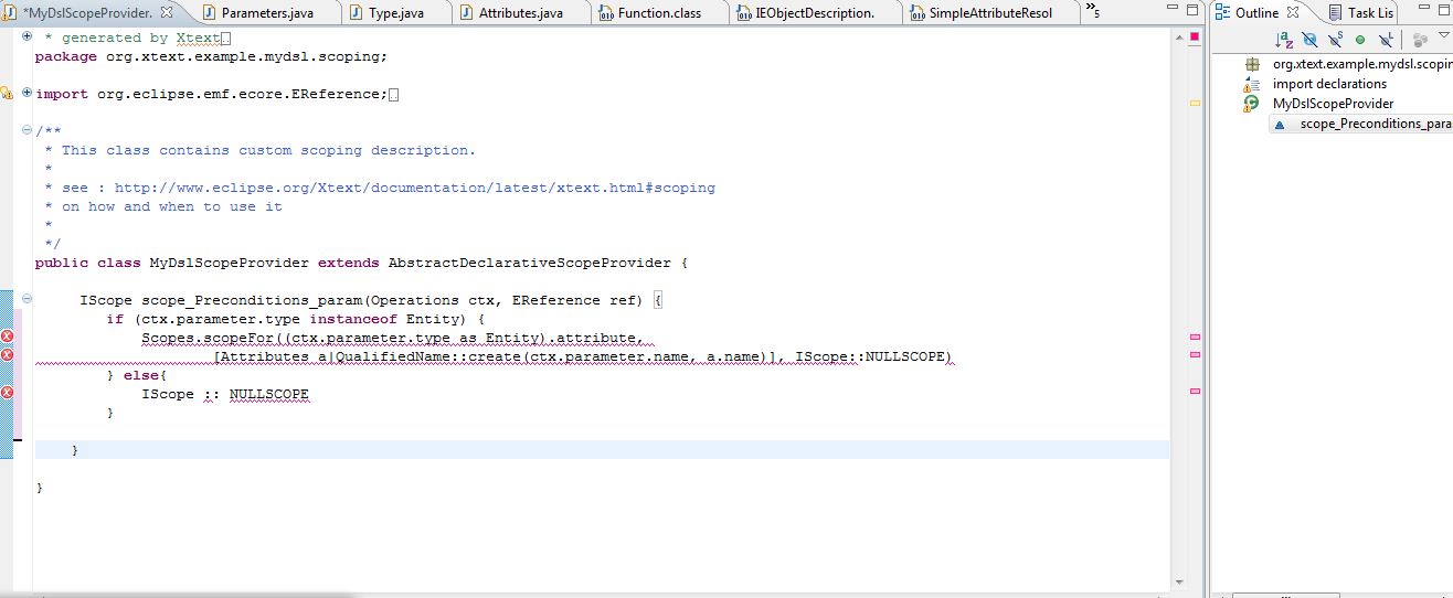

Re: Issue generating a DSL grammar [message #1031667 is a reply to message #1031110] Mon, 01 April 2013 23:41 Go to previous messageGo to next message
I'm working with Eclipse framework in the class MyDslScopeProvider such as you can see in the attached image https://skydrive.live.com/redir?resid=505EBE8B3650C880!369&authkey=!AIyAxssJNCttJyc. If I put the code ([Attributes a|QualifiedName::create(ctx.parameter.name, a.name)]) in the class a compilation problem ocurrs. I'm having trouble translating this code by one who can understand the tool in Java.
Thanks for you help.
Re: Issue generating a DSL grammar [message #1031736 is a reply to message #1016319] Tue, 02 April 2013 02:16 Go to previous messageGo to next message
you could try this:
return Scopes.scopeFor (((Entity)(ctx.getParameter().getType())).getAttribute(),
  new com.google.common.base.Function<Attributes, QualifiedName>() {
    public QualifiedName apply(Attributes a) {
      return QualifiedName.create(ctx.getParameter().getName(), a.getName());
  ,IScope.NULLSCOPE);
and define the method args as final e.g. "final Operations ctx".
[Updated on: Tue, 02 April 2013 02:18] by Moderator
Re: Issue generating a DSL grammar [message #1031737 is a reply to message #1031667] Tue, 02 April 2013 02:17 Go to previous messageGo to next message
hmmmmm id thought you would find out that much yourself.
If your class is a java and not an xtend class you have of course to use a annonymous inner class of com.google.common.base.Function<T, QualifiedName>
