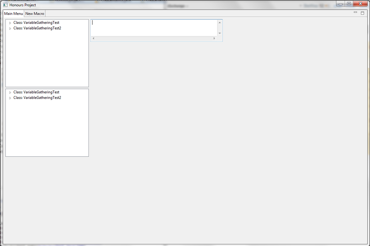

I have an Eclipse RCP application with 2 `Parts` (Main Menu and New Macro) in a `Part Stack`.
I've attached an image of what the UI looks like because I can't post images yet!
When the application starts it calls the `CreateMainUI` contributing class below which constructs the UI and populates some things.

It does this fine as you can see in the picture but when I change `Parts` by clicking on the New Macro tab it executes the below code which gives me an error, saying "no actual value was found for the argument "Composite"."
