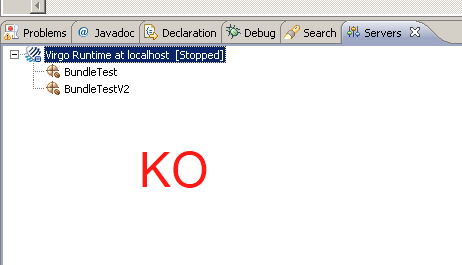

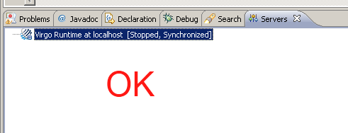

I have put exported bundles in pickup and start the virgo with the server eclipse tab (not with the startup.bat).
All work when i don't add the bundles in server eclipse tab.
index.php/fa/13617/0/
I have the problem only when i add bundles in server eclipse tab.
index.php/fa/13618/0/
