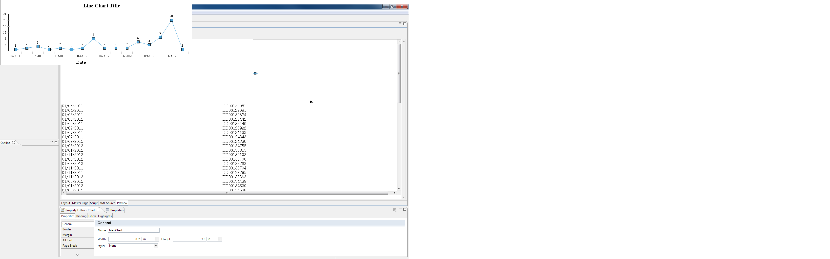

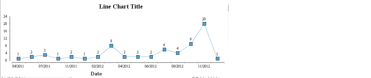

Re: HowTo sum (accumulate) aggregate values in chart BIRT Eclipse [message #1009494 is a reply to message #1009297] Fri, 15 February 2013 03:28 Go to previous messageGo to next message
Hi Michael,
Thank you for the info.
I will try to explain step by step what I did and attach the chart I have got.
I have a table with Date, ID (2 columns). I use it in the chart (i.e. Select Data field is "USe Report Item" and I choose the table with the 2 columns).
I create the chart and:
1) In the 'Select Data' screen of your chart, for Category (X) Series select the DATE field
2) right of 'fx' you can select the X axis grouping : at this step I have choosen:
- Data Sorting: Ascending
- Grouping: Enabled
- Type: DateTime
- Unit: Month
- Interval: 1
- Aggregation Expression: Count
3) In the Value (Y) Series field, put ID: In this case I have put row._rownum (number of items in a month)
4) To the left of the Value (Y) Series field, in the dropdowm menu I choose "Count" as you suggested.
The result is attached picture.
AS you can see we have the number of items for each month. (e.g. 04/2011, 1; 06/2011, 2; 07/2011, 3; and so on).
BUT what I would like to achieve is to have a sum of them (accumulated per month) (e.g. for the example above I would like to have a chart showing : 04/2011, 1; 06/2011, 3; 07/2011, 6; and so on).
Could you please help me on achieving this? I think I miss the little final step to get it.
I really appreciate your help.
Alberto
Re: HowTo sum (accumulate) aggregate values in chart BIRT Eclipse [message #1009497 is a reply to message #1009494] Fri, 15 February 2013 03:30 Go to previous messageGo to next message
Hi Again,
Sorry for the previous attached picture.
I hope this is better Smile
/Alberto

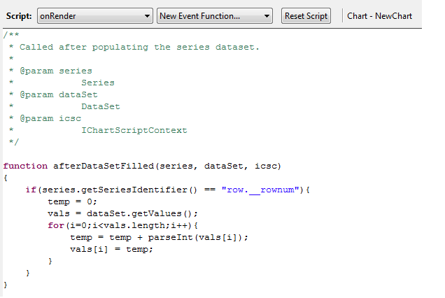

Try adding a script like this to your chart's script. Make sure you change "Series 1" in the script to whatever you've named your series.
function afterDataSetFilled(series, dataSet, icsc)
if(series.getSeriesIdentifier() == "Series 1"){
temp = 0;
vals = dataSet.getValues();
for(i=0;i<vals.length;i++){
temp = temp + parseInt(vals[i]);
vals[i] = temp;
Re: HowTo sum (accumulate) aggregate values in chart BIRT Eclipse [message #1010779 is a reply to message #1009874] Mon, 18 February 2013 03:20 Go to previous messageGo to next message
Hi Michael,
Thanks for your info.
I have added the script as you suggested. Attached you find the picture of the sutup.
In the "Series 1" I have put "row.__rownum". This is because I use "RowNum" in the series 1 in the Chart setup.
But the chart is the same as in the attached picture in my previous message.
What I would like to do is to understand what is the script is doing.
First I can see that the script is executed onRender. Is it correct?
Than I can see that vals[i] has the sum of the values of the "series 1". Do I need to use it some way?
Please let me know
Alberto

Series 1 is what the series is named. If you go to the series section of the format chart tab in the chart editor, you'll see a text box for the series name. Enter a series name here and use this as your "Series 1".
What the script above does is checks that you're dealing with the wanted series, "Series 1", then steps through that series' values and sums them. Each step through the series values, the current running sum replaces the current value in the chart's dataSet. The computed columns approach, offered by Jakob, would work, too.
Re: HowTo sum (accumulate) aggregate values in chart BIRT Eclipse [message #1011555 is a reply to message #1011128] Tue, 19 February 2013 14:40 Go to previous messageGo to next message
Hi Michael and Jakob,
yes it is working!!!
You are simply amazing!!!!
I have implemented the Michael solution and it is working. I didn´t try the Jakob solution but really, really thanks for your help.
I have attached a picture with the chart that is now displaying the accumulated values.
Thanks again both of you Smile
Alberto
