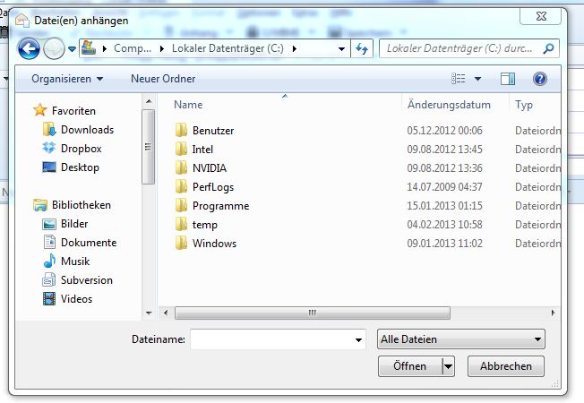

I've created a GMF Editor which works fine so far.
What I want to do now is implementing a popup which opens when an user clicks on a node. This popup should realise some kind of a file manager, like the attached immage. The user should be able to choose a file somewhere from the drive and then the file path should be stored as an String attribute in the gmf model.
Hope you understand what I mean. Is there any chance to realise something like that? Maybe eclipse provide some support.
