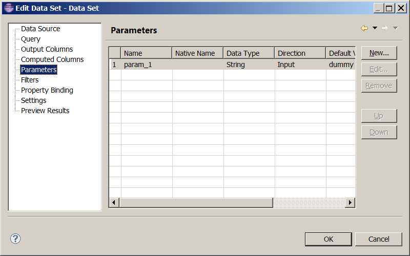

Re: Custom ODA driver IDataSetMetaData usage [message #1006264 is a reply to message #1006051] Wed, 30 January 2013 10:51 Go to previous messageGo to next message
I just looked at this and the parameters entry shows up for me.
The getParameterMetaData method is actually called from the dataset wizard page:
(CustomDataSetWizardPage.java)
try
IParameterMetaData paramMd = query.getParameterMetaData();
updateParameterDesign( paramMd, dataSetDesign );
Am I misunderstanding the issue?
Jason
  • Attachment: odaparams.png
    (Size: 28.18KB, Downloaded 210 times)
