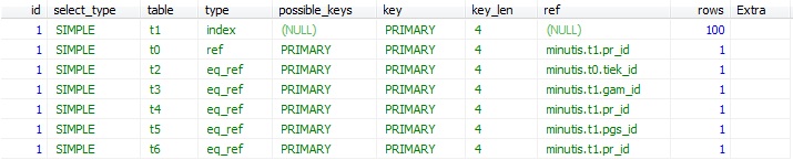

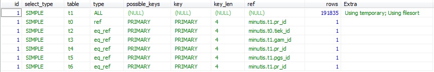

criteriaQuery.distinct(true) is not an option for me. Because that command hangs the whole statement and if I use EXPLAIN:
If I use GROUP BY on the query, then EXPLAIN is:
Images are attached
It give the following SQL statements both times (with and without criteriaQuery.groupBy(from.get(minutis.Preke_.prId));):
SELECT ... FROM preke t1 LEFT OUTER JOIN preke_tiekejas t0 ON (t0.pr_id = t1.pr_id) LEFT OUTER JOIN tiekejas t2 ON (t2.tiek_id = t0.tiek_id) LEFT OUTER JOIN gamintojas t3 ON (t3.gam_id = t1.gam_id) LEFT OUTER JOIN google_compare t4 ON (t4.pr_id = t1.pr_id) LEFT OUTER JOIN grupe t5 ON (t5.pgs_id = t1.pgs_id) LEFT OUTER JOIN preke_kaina t6 ON (t6.pr_id = t1.pr_id) ORDER BY t1.pr_id LIMIT ?, ?

This is also posted here http://stackoverflow.com/questions/14501589/eclipselink-group-by-is-not-working
Please turn EclipseLink logging on and show the SQL that it generates, and what you are after. The best solution will probably be to just remove the fetch join.
