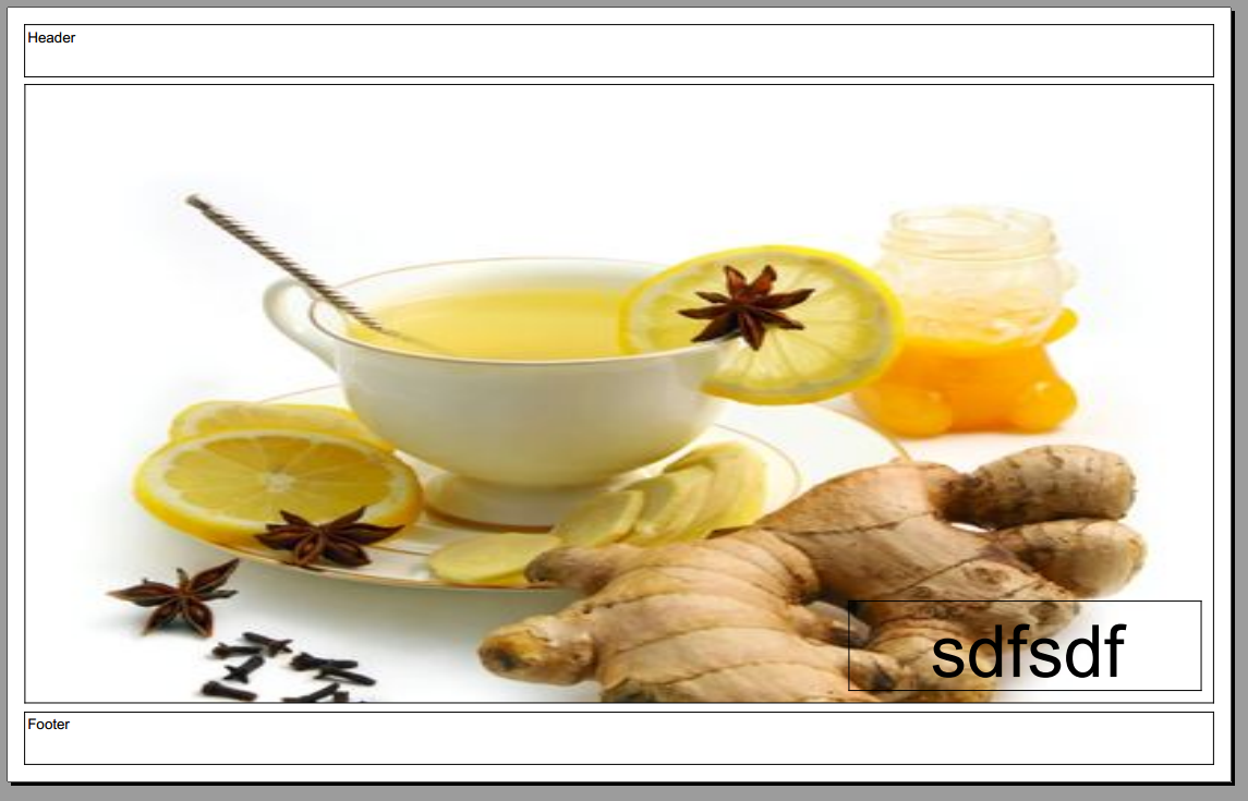

I have a table, each of its row contains an image (its size is as wide and as hight as the page except header and footer) and a grid.
I would like to move that grid up, so it will overlap the image like below
index.php/fa/12878/0/
I do that by setting top margin to the grid -50mm. The problem is, it cant produce PDF report. The PDF is corrupted and there is stacktrace:

If I change the image height so both, the image and the grid are on one page, then it works, but the image is not as high as the page.
How can I do that? Thanks

Re: How to move a report item from one page to the previous. [message #997198 is a reply to message #997183] Fri, 04 January 2013 07:40 Go to previous messageGo to next message
The only way I can avoid the NPE and thus generating the PDF report is setting this options
renderOption.setOption(PDFRenderOption.PAGE_OVERFLOW, IPDFRenderOption.CLIP_CONTENT);
This works fine but unfortunately only when the table's dataSet contains one row. If there are two or more rows,
they are cutted off instead of creating another pages.
Re: How to move a report item from one page to the previous. [message #997275 is a reply to message #997198] Fri, 04 January 2013 16:43 Go to previous messageGo to next message
Maybe something like this solution would work for you:
BIRT-Exchange Forum - Text on Image
Re: How to move a report item from one page to the previous. [message #997416 is a reply to message #997275] Mon, 07 January 2013 06:26 Go to previous message
Thanks for your suggestions Michael. But it won't work for me because a background image in Birt has to be embedded or from shared resources. So it has to be static.
And I need that image to be dynamic from a dataSet.
